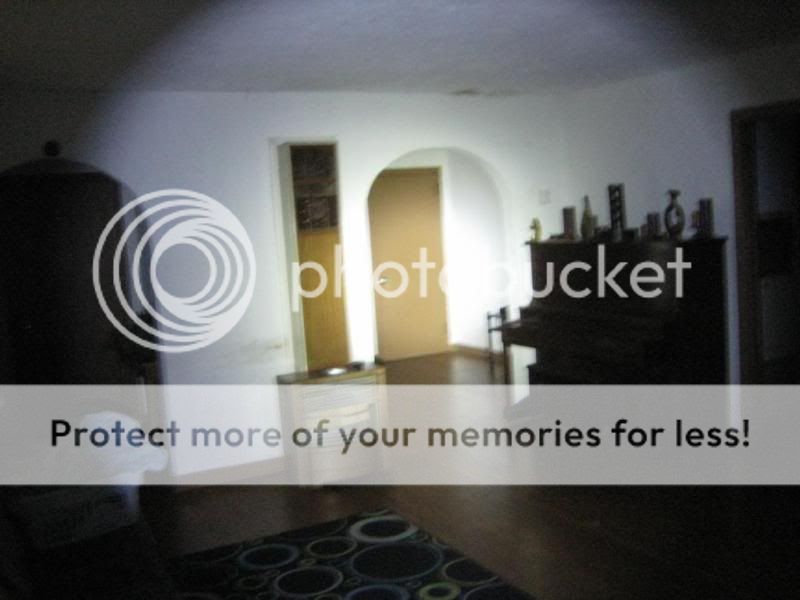

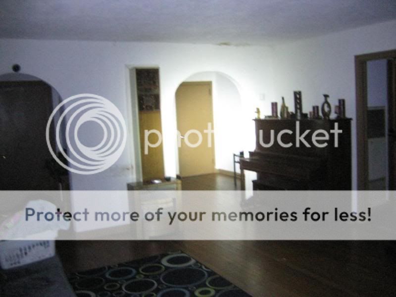

Anyway... Some crappy beamshots - These don't do it justice... Both pictures were taken seconds apart in a darkened room ~11AM.
Manafont Ultrafire 3-mode XM-L T6 drop-in wrapped in copper in L2T host with McClicky switch, AR coated UCL lens, and freshly charged AW IMR 18650, target was the brown door in the distance:
Manafont Sky Ray 3xT6-818 "4000 lumen" light on a pair of freshly charged protected AW 2600 cells, same target:
..sorry, I don't know how to post images here yet...
White wall shots at close distance are better at showing the sheer brutality that this thing exhibits over the Manafont drop-in... It is insanely bright and as you can tell, super floody...
