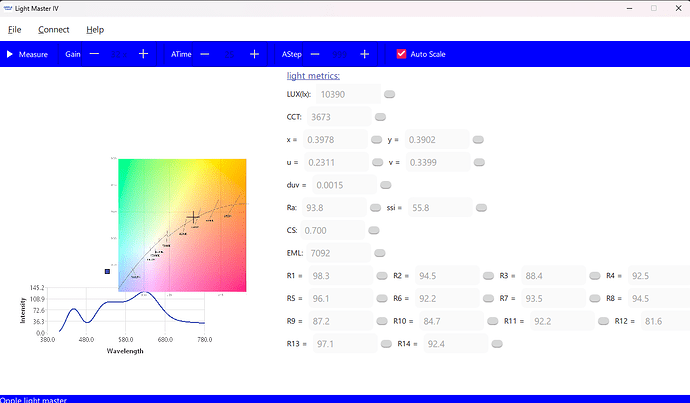

Here is the link to the version I am using.
Also, this is the screen shot.
why its R9 precision is so bad?
did you record Ra measurements? How about Ra precision?
Please let me know why. You are the developer.
Please read. Ra numbers are in my previous post. Why are you asking obvious questions when the answers are right in front of your eyes??
sorry
seems ML method is not that bad in terms of Ra/R9, but I think spectral reconstruction method’s generalization ability is much better than ML method, you can test other light sources, for example CFL light and daylight, I can guarantee that ML method will fail, especially for CRI(Android/iOS app uses ML method, while my PC software uses spectral method).
