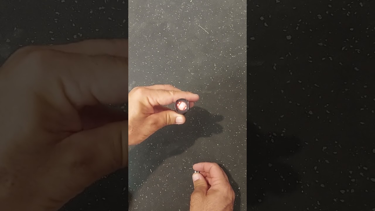

In the pic a few posts ago i showed the convoy light next to one of these
It fits snuggly in the tail. With a bit of work i sanded it down and fitted a switch to it. Result is an illuminated tail with chasing leds. There are a few different modes that can be accessed by waving a magnet at the tail.
Room for improvement
  • better finish / presentation of the tail
  • incorporate the magnet into a pocket clip somehow
I don’t think i’ll get it done before the deadline so i’m just showing you what i have.
