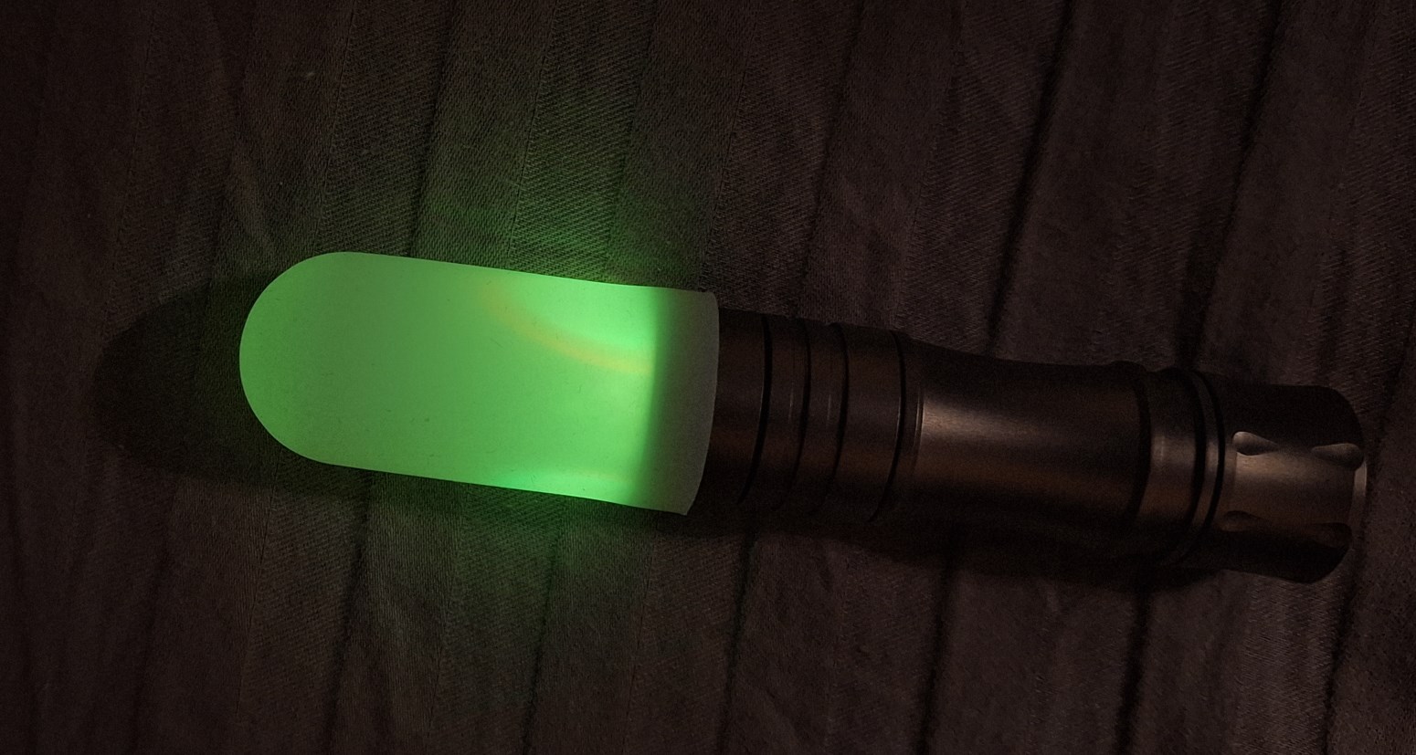

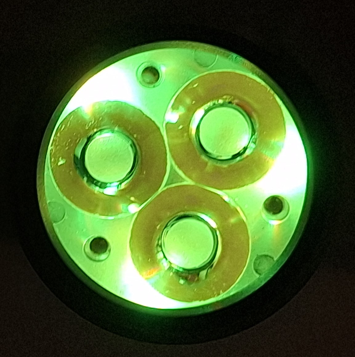

One issue i have with both “rainbow” and “stoplight” is that both assume that color mixing works. The reality is - it does not:
This is yellow on TS10v2, does it look like yellow? Colors are not properly mixed and worse - proportions are not right for it to be yellow anyway.
For it to be proper colors full ramping would be needed for each color, proper proportions will have to be programmed for each light and it’ll have to be properly diffused.
IMO very simple indication with available colors only (red, green, blue) would make the most sense. Perhaps simply green-blinking green-red-blinking red with 25% per step.
This is, actually, one part of why current implementation is totally worthless for me. Color mixing does not work and as a result indication does not make any sense most of the time…

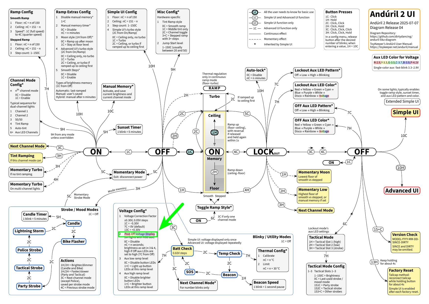

Coming back to the aspect of discoverability: fwiw, for a further visual example of the discoverability of the POVD, be it enabled or disabled by default, cf. this recent post of mine over at the Anduril 2 UI diagrams thread, where I “dimmed” all the Advanced UI information - except for the POVD.

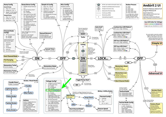

Moreover, in the current release of this diagram by myself, the POVD should be even more eye-catching in the now expanded Voltage Config box:

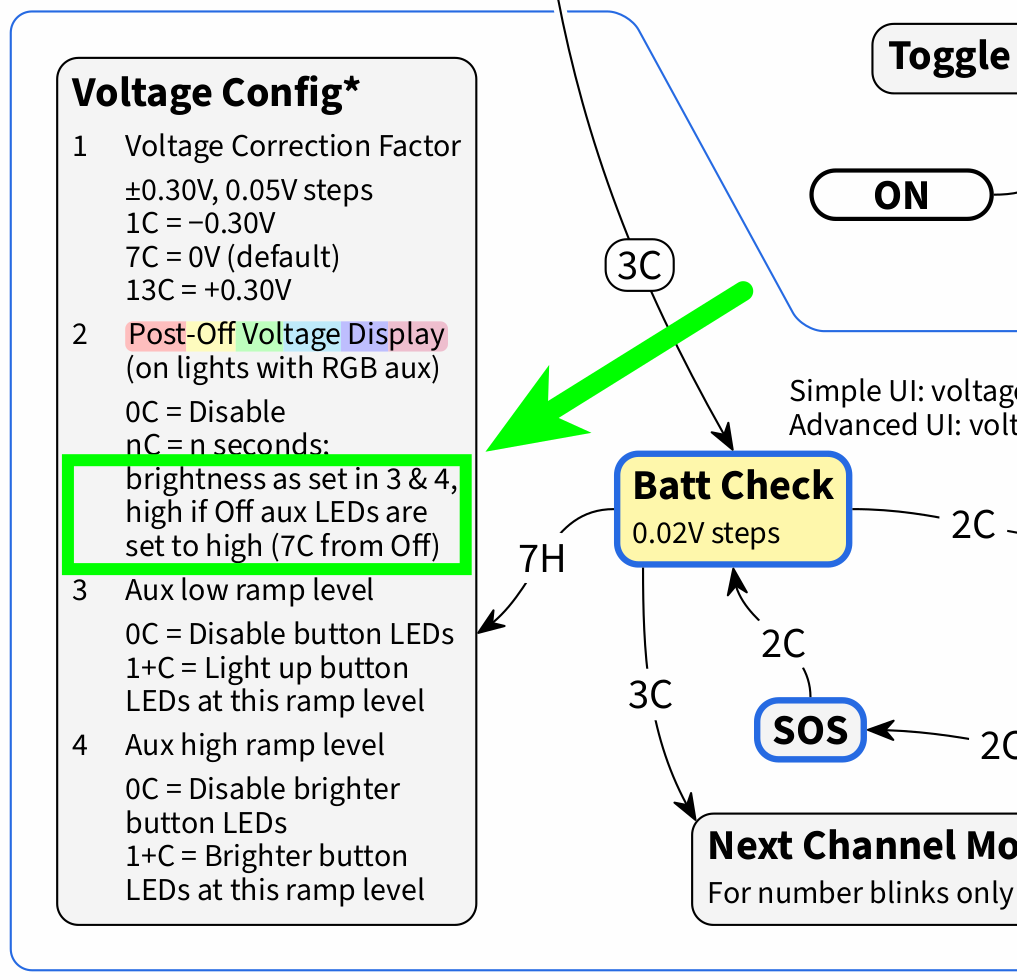

Please also note that by now, with TK’s latest Anduril 2 release 2025-07-07, the POVD brightness can be configured:
WIth all that said, the POVD still remains enabled by default, but there it is.
