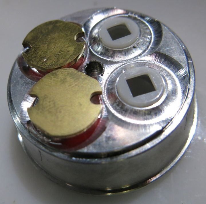

I have just finished building a quad SRK up to test Tom E’s driver and find out what sort of spread the XPL emitters would give in this light.
I’ll start with the driver. Wow. What doesn’t this driver do. I’m probably the last person to ask to test a driver like this as I get lost in my driveway let alone try to get my head around the workings of this driver. I’ve been playing with it outside in the shed, the driver hooked up to an led and my power supply and got so lost.
I eventually had everything together to assemble the SRK when I dropped the lens and yes it shattered, me as well.
The light is now operational after waiting nearly three weeks for a lens. I started with this light. The XPL leds sit on 16mm Noctigons which themselves sit on a 5mm plate. The depth of the head was machined to suit the above stack. 20AWG wires channel the current to the leds from the Narsil driver which has the latest firmware. The stock springs in the tailcap were given a bypass with 18AWG wire.

The SRK front on with the four XPL emitters. One day when I grow up I’ll be able to solder like Tom E and not melt isolators with the soldering iron.
And finally one of the reflectors backside showing the Noctigons and isolators used. On this light I relieved around the reflector holes to prevent any possibility of me able to create shorts.
