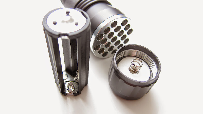

This is my first light with a battery cage. My opinion of them has changed. Loading this with cells was easy, unlike some DIY battery packs I’ve bought in the past. I put in three freshly charged AAA eneloop cells and turned it on. It actually has some throw (enough to be useful around the house)! I can also see the appeal of this 3xAAA form factor compared to wider multi-AA lights.

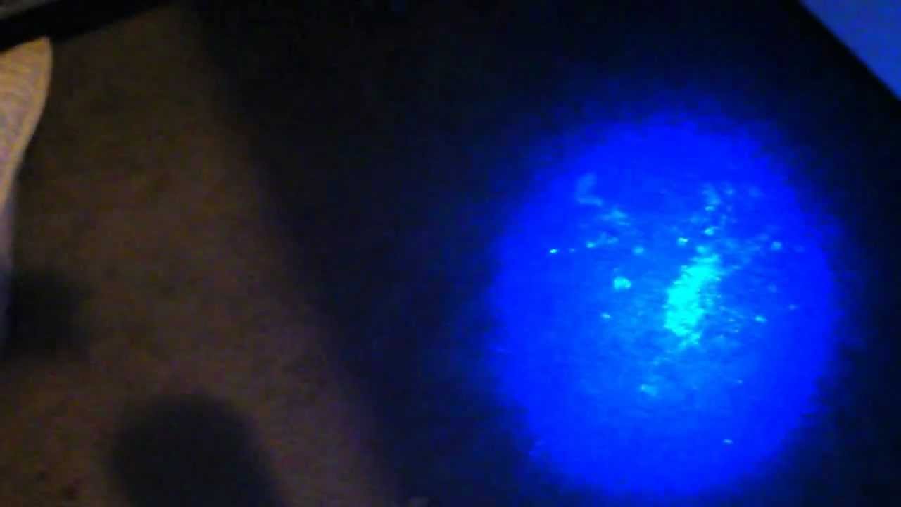

21 LED UV light beam:

The bezel can be removed. There is no o-ring to seal this end:
Tailcap reading showed draw is around 650 mA and declining. This is direct drive; inside there are no components other than LEDs:
