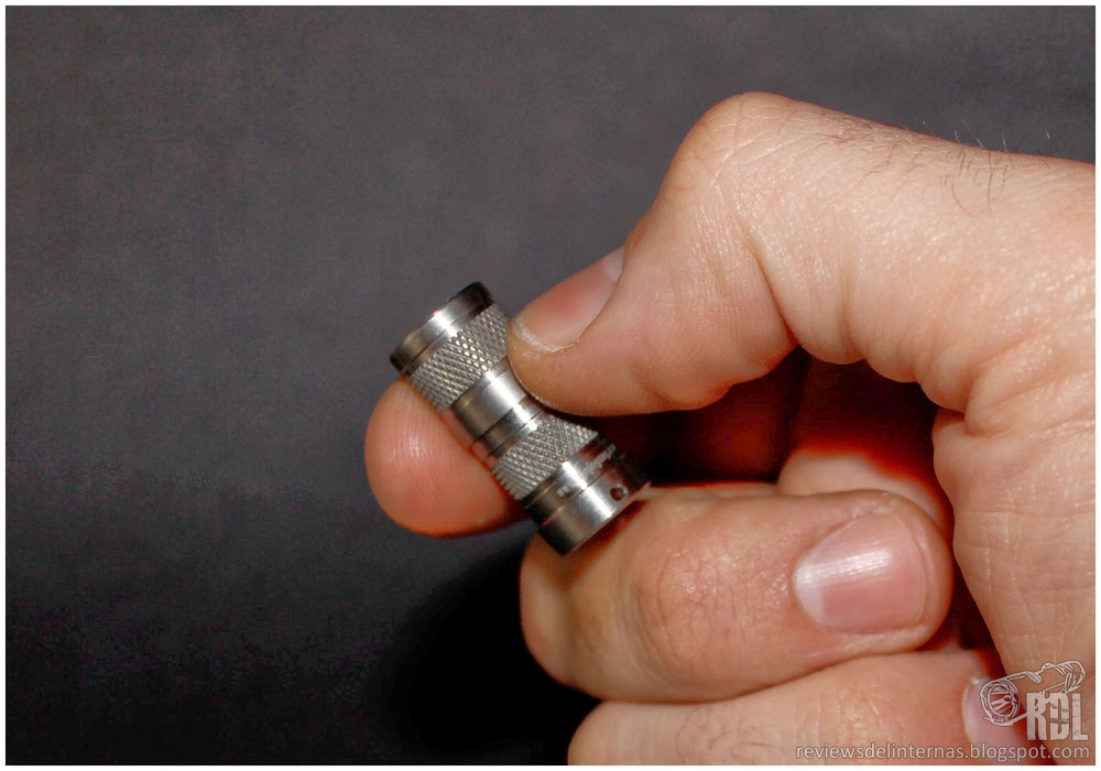

The DQG Spy has a very familiar appearance, as if a DQG TinyAAA were reduced.

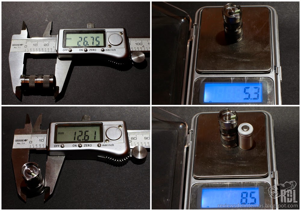

Mechanized Titanium has a size and difficult weight imagine, really small and light. With just over 5 grams is 10180 torch certainly lighter on market, and also length beat the competition offered by other similar lights manufacturers.

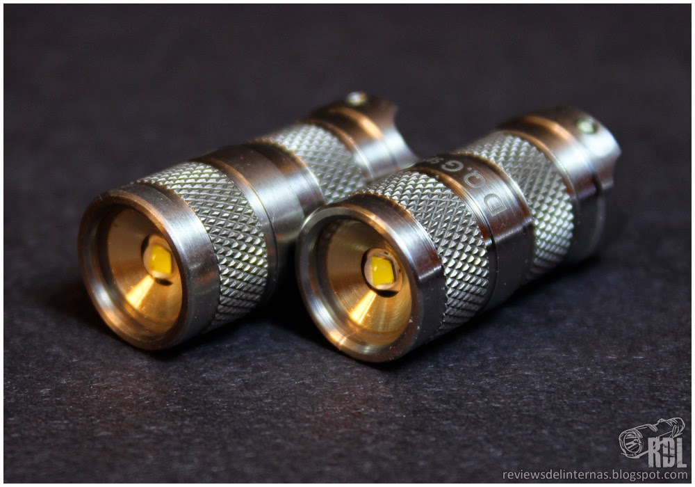

The head of the SPY, very similar to the AAA, with a small knurling area between the bezel and neck. This new DQG dispenses with classical TIR lens found in the previous lights from this same manufacturer, and introduces the “mule” concept, with the LED without any collimator at its emitter and so beam provided would be purely flooder. The LED is located behind a *quartz lens *on the first batch (already sold out) and will have glass with AR treatment in the next batch by specifications provided by the manufacturer.

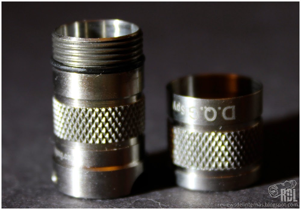

The threads are very similar to those found in the AAA version, even being compatible in its pitch. As I have been told, the next batch of SPY will be slightly modified in design to the interchangeable heads with O-ring AAA is completely within the neck.
Edited: As I’ve been told today, the thread modification to fully match DQG AAA body is not possible due size issues.

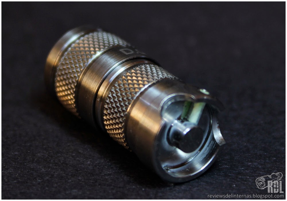

Inside we see the positive contact of the circuit, surrounded by a protective foam that acts as a mechanism against inverted battery fitment, and prevents the battery from ranting when the flashlight is off. Among the knurling and neck there is a discreet but quite legible lettering recorded with the make and model of the flashlight.

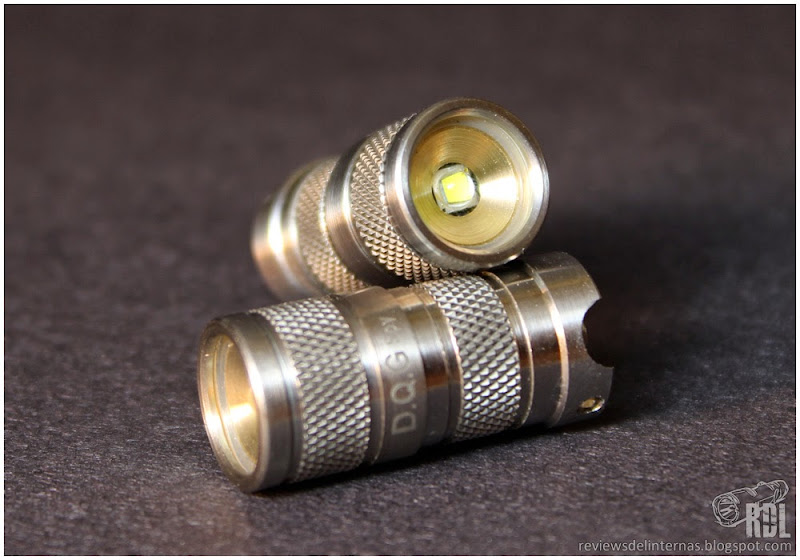

The small tube, as in the AAA versions has no spring inside and instead there is a lug directly machining in the bottom. The exterior design features a “scale-like” AAA version, with a very interesting tailcap in which we find a drilling for the chain ring, and a second hole in which CNQG has installed a tritium vial.
This tritium vial is like the old GITD point of AAA but with the peculiarity that needs no previously “charge” of light to glow in the dark because there is inside there is a gas radiolucent that emits light by itself. More information on the tritium and the radioluminescence.
We can choose the color of the luminescence of tritium in CNQG web interface between the green typical “radioactive” and orange. We can even acquire additional vials to change or add any extra if we are handy with drill.
Tritium vial installed appears by cyanoacrylate adhesive, and there are abundant traces of this around the tailcap of the two units that I have in my possession.

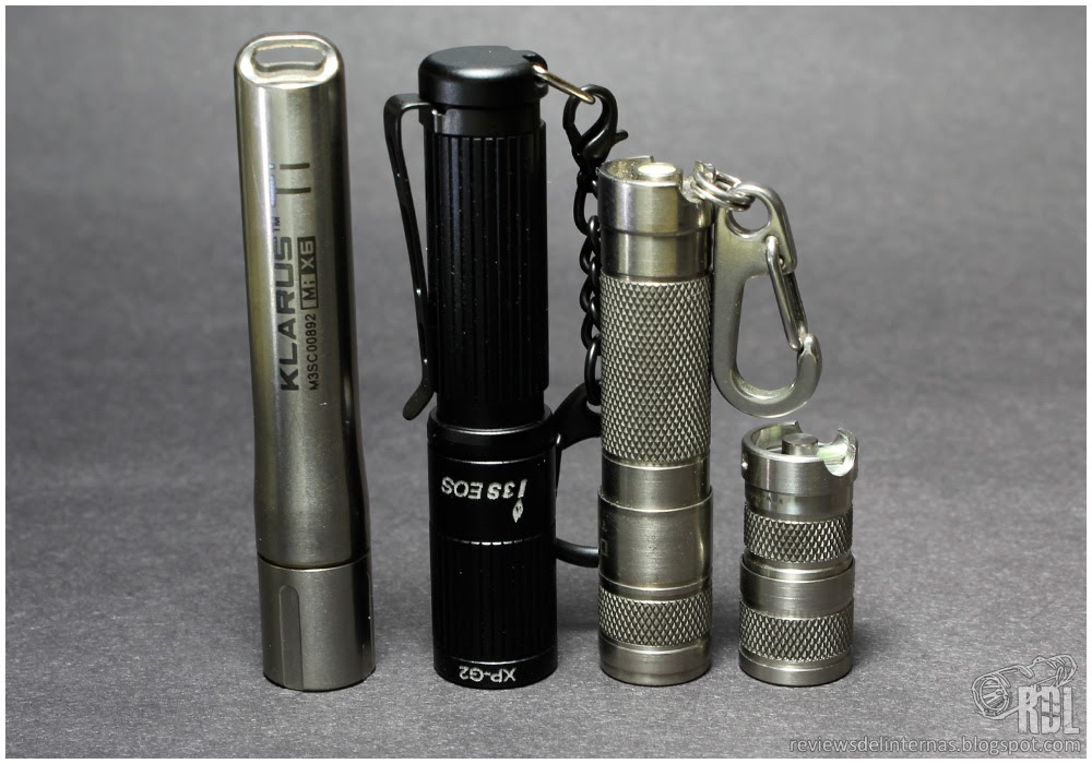

A couple of pictures to compare their size and design with other 10180 flashlights:
(Pictures courtesy of stirner)

The new concept of optical “mule” type featuring a much floody beam than the AAA versions, with no hotspot in its huge lighted area evenly lightened. Light angle is also much wider than that offered by the AAA TIR lens.
The tint in both flashlights is very nice, XP-G2 R5 1A for cold white and XP-G2 R5 4C for the neutral white variant.
Without reflector or collimator lens, the SPY offers a beam covering a huge area by flooding homogeneously without a defined center hotspot, although if increased the shutter speed camera can pick how the metal lining the perimeter of the LED collimates some light.
Therefore, the angle of light is much wider than any other AAA flashlight equipped with reflector or TIR lens.
