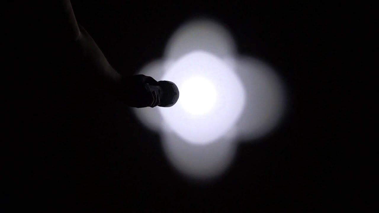

at the End of part 1 i have a small gif to show mode spacing and beam profile
(ISO 200 / F5 / 1/4sec)
