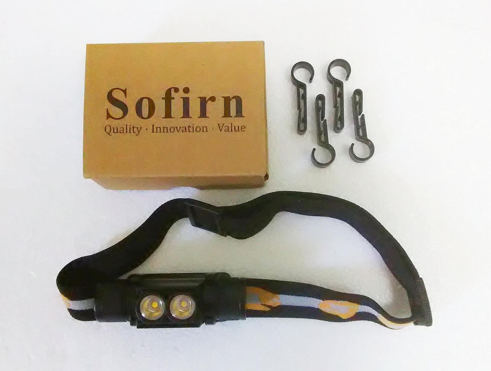

The headlamp comes in a really compact box, sturdy (folded over sides and a locking lid), nothing fancy but still secure.
sturdy Sofirn box (click the pic!)
Inside the box is the light itself with included cell (be sure to remove the insulation tab to use it) and headband as a unit, a folded-sheet manual, and 4 clips which look quite useful but I have no idea what they’re for. :laughing:
(Edit: apparently they’re to adapt the headband/headlamp to construction hats.)
D25L box and contents
