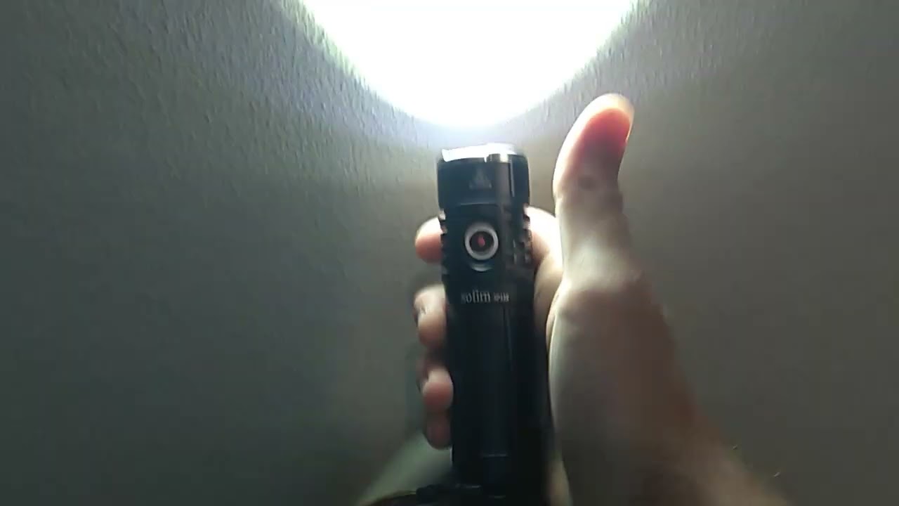

Someone on TLF asked about the shake resistance of the SP33S. So I made a video:
That is common thing in flashlights that specifically use proprietary battery.
It happened to me with Acebeam E70 when using other than stock cell. Solution is to solder longer BeCu (if possible) spring either on driver or tail and you can go with whatever cell you like and it will not do that thing in video
The problem is the brass contact at the positive side, the very spacious inside and the heavy battery. If you want a wide compatibility with various batteries, use springs on both sides.
The positive end of the battery is also more easily deformed or dented by "the brass contact at the positive side" than it would be if there was a spring there instead of a brass contact.
I'm fairly careful with my lights, but I have noticed the positive end of some flattop batteries (with weaker construction) eventually end up being pushed into the battery slightly when used in lights that have brass contacts.
