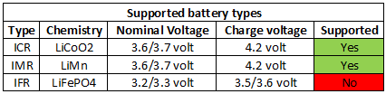

The charger is not rated for 26650 batteries, but it is possible to put one or two in the charger and charge them.
