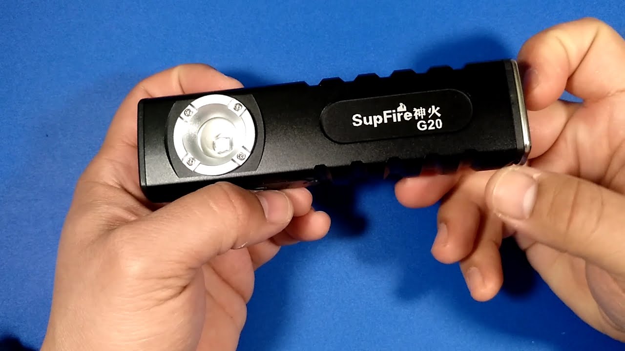

What to say about the flashlight?
It is good, better than I expected, but it is not 100% perfect, and it was not supposed to be. Not for this price.
It is heavy, really heavy, and robust, but it has some frailties, namely in the head and tail, where the thick aluminium gives place to “thick and though” plastic parts.
I do like that it has a front and side LED and the laser, which allows reaching different ranges, even if the flashlight is not extremely “powerful”.
Actually, I don’t think it really has 500 lumens, I would say that it reaches between 300-400 lumens on the front LED. As for the lowest levels, they reach 2 or 3 lumens, but I cannot measure it accurately.
Overall, the G20 is a multifunction flashlight, once it has:
- Front cool white led, under a SMO reflector
- Side high CRI Led, under a convex optic
- Red laser pointer
- Powerbank function
- Magnetic tailcap
- Hook in the tail
- Powerful pocket clip (really :o)
Besides this, it is rechargeable via USB-C and has 4 led indicators for the battery and charging status. These are located above the 2 e-switches located in one of the thinner sides of the flashlight. Opposed to it, there are the charging/discharging ports, covered by a good silicone cover.
The magnetic tailcap is not the strongest one, and in some positions the flashlight – being so heavy - , may fall (side led to towards the floor) :zipper_mouth_face: In others, it holds pretty well (side led towards the top or to the sides). It also holds well when the flashlight is put upside down in the vertical position.
The grip is good, the flashlight feels well in the hands. The switches can be located well, despite you need to remember in which side they are in, specially because the silicone cover to protected the USB ports also has a similar texture. They are reactive and act well when pressed.
As for the battery, being only 2000mAh, it will end your juice pretty fast! I didn’t deplete it yet though and I used it for a while already ![]()

Top and bottom photos. These are the plastic parts, which I consider to be more fragile if the flashlight falls, despite this is hard plastic. It felt to the ground from around 1m and did few damage, nothing broke, but bruised.
Some details on the top and on the tail (hook) and side. I didn’t dismantle the tailcap and the side led…yet
As for the head, I am not sure if I will take that risk.
As for the charger and powerbank function, the USB-C charging/ USB discharging ports are located in one of the thinner sides of the flashlight, covered by a silicone cover.
When charging, the indicator led corresponding to the charging level will blink. I didn’t discharge it yet to see if they turn red, so, so far, I only saw then in green!
Also, I didn’t make a full charge to see how it acts when the charging is finished. There is no way to measure the battery voltage/charge, so the led indicators are the way to verify it.
When discharging, while used as powerbank , the side leds will be ON, as well.
The powerbank function allowed charging both a flashlight (with built-in charger) and a battery (via the Olight UC charger). I also experimented it on the cellphone and it was charging too.
Sorry, no values for current IN or OUT :zipper_mouth_face:
And now, let’s check the weight and dimensions. Yes, it is heavy and bulky. But I guess it has some thick walls. If I can I will show it later!
As for the Magnet, Hook and Pocket clip, they allow using and carrying the flashlight in different ways.
The magnet is better when using the side LED towards the top or the sides, as mentioned above, or with the flashlight upside-down.
The hook is good to use the flashlight…hanging! That’s its function so it will work for that. The hook can be pulled easily but it doesn’t come out of its place accidentally, which is good.
As for the pocket clip, it is probably one of the strongest clip in a flashlight I ever had/seen. It allows carrying the flashlight inside or outside the pocket and provides good, if not excellent, retention.
