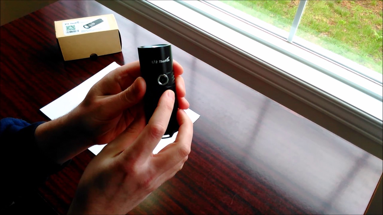

First, the box.
Contents:
I believe the contents are supposed to also include a carry-pouch, but my review item did not include this.
Various pictures of the Thorfire TK4A.
