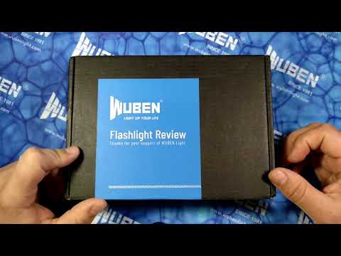

This is my review (video + written) of the Wuben D1 flashlight!
The flashlight was sent by Wuben for review with no other compensation than keeping the flashlight and accessories. Thanks Cindy and Wuben!
The light is not yet on sale. I will add the link later on, when it is available.
I will do my review in an unbiased way, as I normally do, being it gifted or bought! ![]()
VIDEO OVERVIEW
As usual I made some mistakes on the review (namely about the flashlight parts - see comments and see the written review below) and eventually others, but here it is!
NOTE: the video was done without the support of an User Manual, which I received later (digitally). So the information on the written part will be more accurate and complete.
