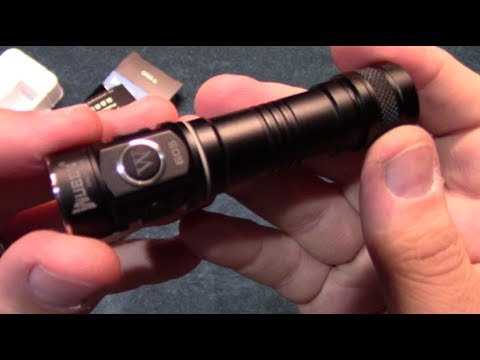

First, the flashlight! The Wuben E05 is a small EDC flashlight with e-switch and using AA / 14500 batteries that is in the line of some other manufacturers.
Some examples that we can easily recall are the Manker E11, Utorch UT01, Lumintop EDC05.
According to specs it is capable of producing 900 lumens with a 14500 Li-Ion battery, straight out from its XPL2 LED.
It has an elegant body shape, being small and thin. Also, it is not heavy being easy to carry on jeans or even a shirt of jacket.
Despite having some fins in the head and some grooves in the body, the flashlight only has small knurling in the tail.
+Machining is perfect and flawless*, at least so far, and even being smaller this flashlight breathes quality, detail and rigour (I’ve learnt it from the other Wuben lights I have, and this only confirms it!!!) :exclamation:
Starting from the bottom, what we have?
Well, first, we have a magnetic tailcap that easily attaches to metallic surfaces. It is not as strong as the Wuben TO10R (which is also heavier) but it accomplishes well its function as shown bellow.
The threads are square and arrived well lubricated, and there is a sealing o-ring to prevent liquids’ infiltration.
The magnetic tailcap is an important part of the flashlight as it is the only place from where we can access the battery , to (un)install it! Unlike “similar” flashlights, like the Manker E11, the Wuben E05 can only be unscrewed through the tail ( well at least I didn’t see any mark on the top of the battery tube that could lead me to the conclusion that there are threads there! )
Above the tailcap we can also notice a battery symbol, indicating the adequate polarity for the batteries.
Inside we find a “thin” but strong golden spring. From the tail, e can see the brass surface (tip) from the driver, on the positive pole, which seems to be surrounded by some black foam or other material. This surface is flat (apparently), making this light usable only with button top batteries.
Attached to the fridge and my door lock ![]()
And now moving towards the head, what can we see?
On the “front” of the flashlight we have the power button consisting on rubber or silicone cap with a W on it, which will glow blue or red depending on the situation.
Around it, there is a stainless steel ring, being a classy detail! On the top of it, the manufacturer logotype, and below it the E05 identifying the specific model!
In the intersection of the battery tube and the head, there is a glowing o-ring that allows to locate the flashlight in the dark (after absorbing some light). I didn’t test how much it lasts, but I can say that it isn’t much visible with some light. In the darkness it is effective, even not being as visible as glow-in-the-dark tape.
On the top there’s a shinning and slightly crenulated stainless steel bezel (unscrewable) that allows to see if the light is switched ON or not when it is sitting with the head in towards a surface.
Below it there’s an AR Coated glass lens and a thick white o-ring. Inside the head, surrounding the reflector, there’s a thinner white o-ring that helps with sealing issues.
The emitter is a Cree XPL2 (user manual mentions only XPL), which is well centred below a smooth reflector and above a thick white plastic gasket (that I didn’t remove).
Although it is not mentioned if the LED is a Cool White or Neutral White emitter, I believe that this is a Neutral White, mostly due to the UV test that I made above the LED and that revealed an “orange” colour. CW emitters are normally more yellow or pale yellow! Later you’ll see that the beam produces a yellow shift in the corona.
