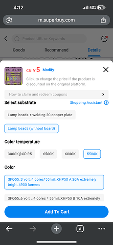

I wasn’t aware of superbuy(.com). For the price they list those LED’s, I certainly am more willing to order several of them for testing, than the 11-12 euro (each!) that Pioneman asks for them. Obviously there also will be extra costs via Superbuy, but I’m certainly going to look into it, to figure out if it might be worth giving it a try.
That 3V/20A rating (for what it’s worth), is already 5 amps higher than Pioneman lists it at. That 4900lm sounds (too) ambitious, but given that it has a smaller LES (at a 5050 footprint) than say, for example, the LHP531, it might still be an interesting LED for it’s intensity, even with a lower lm output.

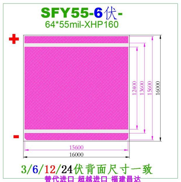

It wasn’t really clear by my post, but I was actually referencing to SFY55 64 die/chip LED, with a 16x16mm footprint, that elemental mentioned in his post. That could/should be a big step up from the SFP55, but it is also substantially more expensive than the SFP55.
It could also not be easy to find a host with a reflector that can house such a big LED.
I haven’t done the total cost calculation of a single SFY55, but at a quick glance on that Superbuy listing, it would at least cost around $ 20,-.

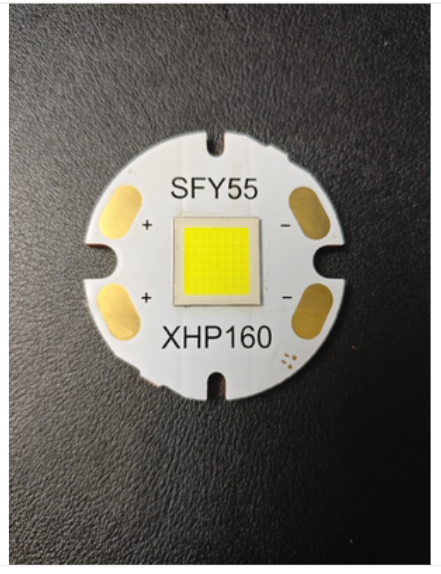

A picture of the SFY55 from the Superbuy listing. Quality/resolution of the photo wasn’t great, but it gives an idea:

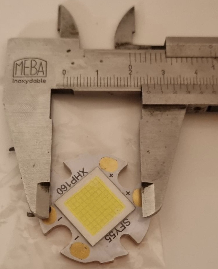

On 32mm MCPCB:
Edit: Photo by @LunaLoves :saluting_face:
The fact that it is on a 32mm MCPCB shows you what a huge LED this is!
Does that photo means you already got one?
No, this is my good friend @LunaLoves’.
It’s so massive it severely limits host options.

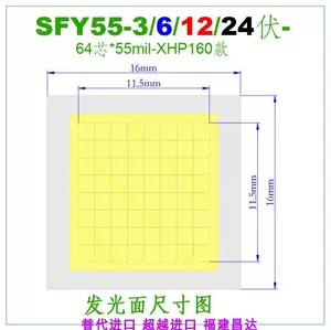

Anyone know where I can get a SFY55 in 12 volt? Or maybe 24v etc?
The only place I’m aware of that sells them in these voltages is on Taobao:
You could order them via Superbuy(.com) via this link:
https://www.superbuy.com/en/page/buy/?nTag=Home-search&from=search-input&url=https%3A%2F%2Fworld.taobao.com%2Flang%2Fen-us%2Fitem%2F733778240253.htm
