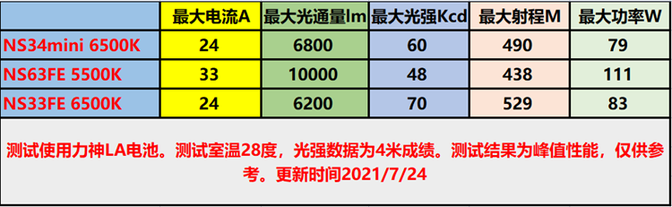

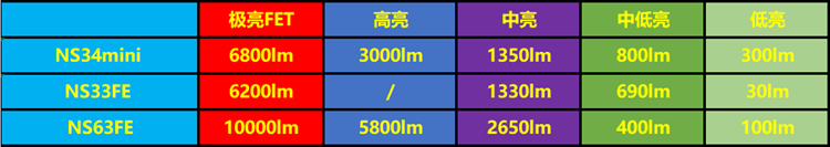

In this page shows the Nightwatch NSX3E "Extreme edition":
https://item.taobao.com/item.htm?spm=a1z10.3-c-s.w4002-17110364424.12.c9f41962lejNlP&amp;id=602358134901
The description (in Chinese), translated, gives these info
NS33FE: 3x SFS80 6500k LED, max 24A current, 6200 lumens, 60kcd (490m)
NS34Mini: 4x SFS80 6500k LED , max 24A current, 6800 lumens, 70kcd (529m)
NS63FE: 3x SFQ60 5500k LED, max 33A current, 10000 lumens, 48kcd (438m)
(comment: SFQ60 LED appears to be in ~5500k color temperature)
How do you know that? Have you tested it? I understand why the SFN55.2 might not be efficient with it’s very low vf. Combine that with a linear driver and yh it’s not gonna be great. At turbo it seems pretty similar to 7x osram 2mm. Pulls about the same current with similar output.
10k Lumens from a single Cell light that draws 33A = ~120 Watts which means ~83 Lumens per Watt
That’s at close to max output. I don’t think a dedomed XHP70.2 will be much different.
I tested the SFN55.2 in a NI03 and got near makes no difference 29 amps at probably 3.3-3.5 volts (6912 conservative Lumens) with the included 26800 battery. I’m thinking of trying a 30T to see if I can get more since I know that 26800 is really working hard at that drive current. Until someone officially tests one in a sphere to prove it, I’ll put my money on the table that the SFN55.2 will be as bright (or brighter) than a 70.2 with less power consumption. Take off the dome and it will be even less output.
