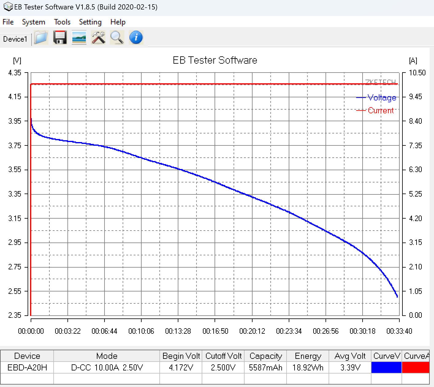

or mine could be a fake :slight_smile:
But I bought it from an authorized reseller. I also tested it at 10A and it mostly matched the curve published on Vapcell’s website.
