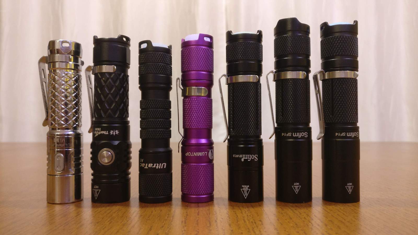

AA group shots
(left to right) Klarus Mi7, ThorFire TK05, UltraTac A1, Lumintop Tool AA, Sofirn SF14 V2.0, Sofirn SF14 (original, x2)

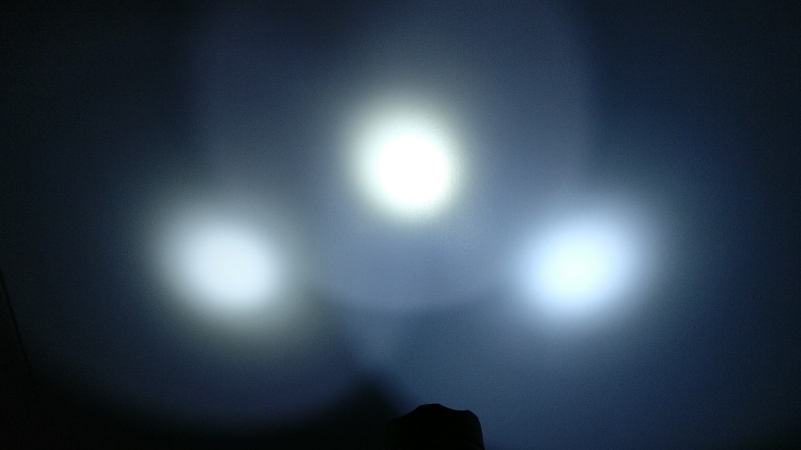

Can you elaborate on the tint, other than the emitter being “near neutral”?
I’d say it’s around 5500K, which seems pretty typical for Sofirn. The below shot below consists of Sofirn SF14 v2.0 (left), Convoy M1 with XP-L 3(D/B?) tint (center), and Klarus Mi7 with cold (unknown tint bin) XP-L HI (right).

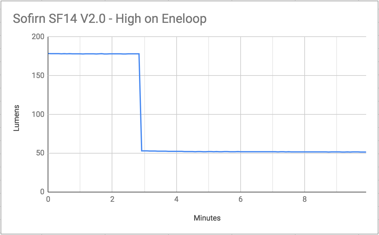

I sampled every 5 seconds (overkill!) and ran it for 10 minutes. I think I’ll re-run it with less-frequent sampling and will let it go until the light runs out. I’ll try and post that later. But for now…
You can see that there is indeed still a step-down at 3 minutes, but it goes from (estimated) 178 lumens to 53 lumens. This lines up very closely to Sofirn’s specs of 180 lumens on High and 50 lumens on Medium. The original was spec’ed at 230lm and 33lm.
