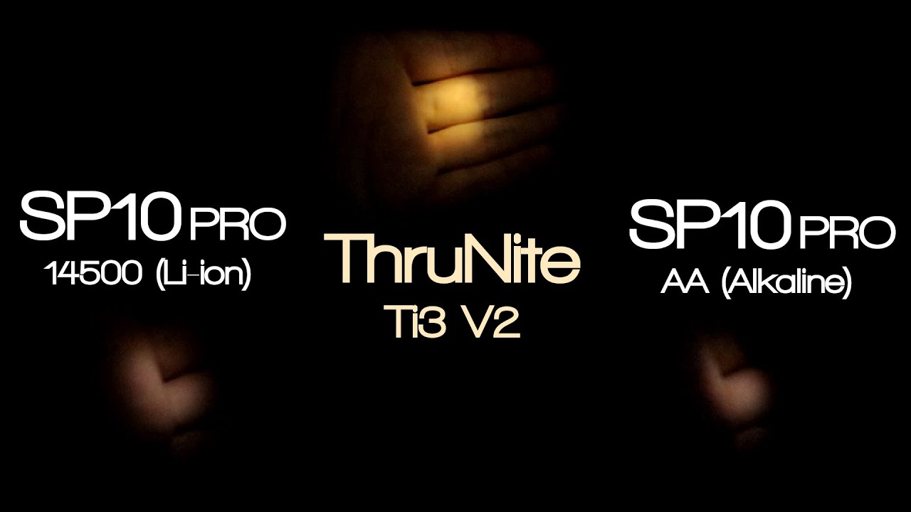

Here’s a video showing the lowest mode that I just made if you’re interested
thanks for the video, looks suprisigly lower than the Ti3… thats great!

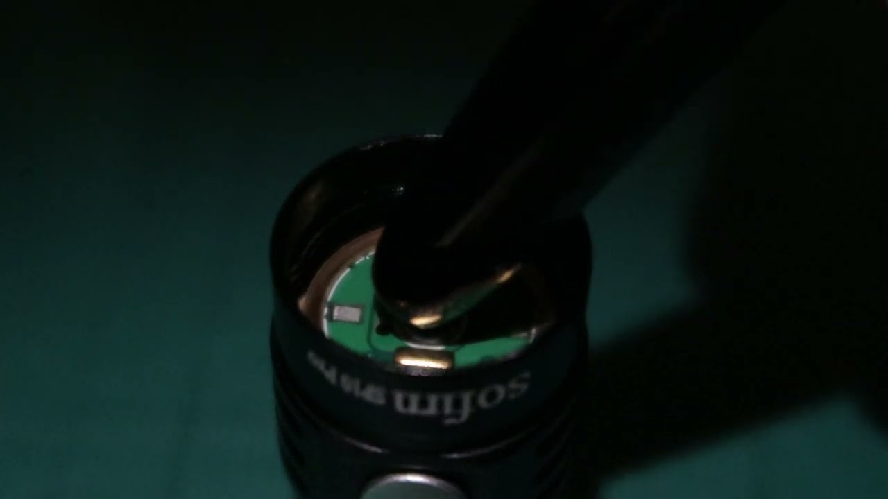

After making that video and swapping from Alkaline to Li-ion, The flashlight now behaves differently when turning off
When I press the switch to turn the light off, the flashlight will step down to a lower level first and then turn off; and other times, the light will flash at max ramp before turning off. I’ve done a factory reset, and it still does this. This happens about 50% of the time.
Currently charging my H10 back up to 4.2v to see if that might kick it up the butt into fixing itself, although it’s wishful thinking!
Update: After charge, still doing it.
Not a good sign. Maybe something loosened, or the tail spring compressed? Are the batteries different lengths?
Does it do that if you put the alkaline back in? Or just on lithium-ion?
Just checked and there is a loose part, yes
The Alkaline battery is shorter than the 14500 by about 1mm, and I had already taken that (the 14500) in and out with no issues these past 3 days…
Also, I tested the stock tail cap against the magnetic, and it happens with both
It does the same thing with an alkaline in, yes

What does version check say? Also, what brightness is the light at before turning it off? If you smooth ramp up and down a lot from the lowest level to medium-ish (like maybe step 1/150 to 50/150), is it always smooth, or does it have a bright flash once in a while?
I ran into some PWM phase sync issues back in September or October, due to the way the attiny1616 handles pulse generation. I fixed every case I found, but it’s possible you may have gotten something with older firmware, or maybe not every case was fixed. It may perhaps need to wait a few extra milliseconds between setting the PWM level to 0 and going to sleep mode.
The only remaining issue I’ve noticed on mine is that sometimes when I turn it off, the LED will glow very slightly for a few seconds while a capacitor drains or something, before it fades out.
