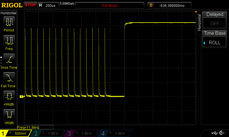

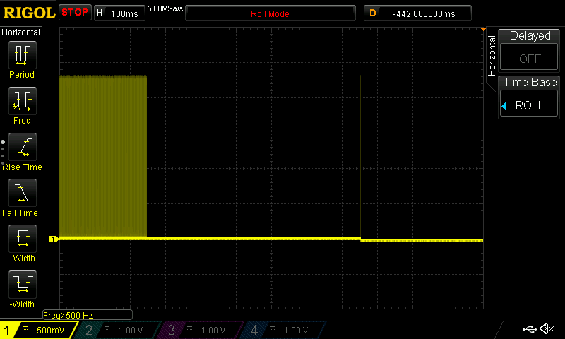

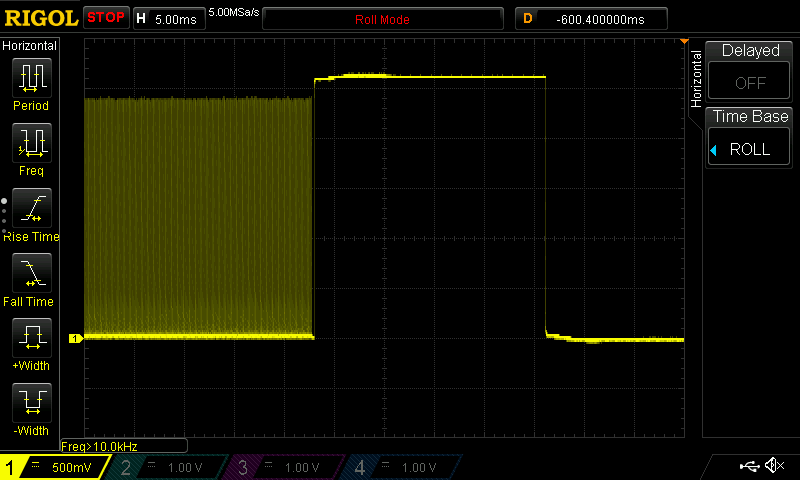

gchart and I had a little debugging session today to fix the turn-off-delay-and-flash bug.
Before: Notice the single pulse half a second after the light should have turned off. My sensor wasn’t able to capture the fading of the LED.
And here is the other case: “bright flash” (detail image)
gchart had already prepared a patch, let’s see how it looks after updating the firmware with that patch:
Now the output is switched off in a controlled manner. There’s still a weird single pulse, but it cannot be seen by eye. I’d call this fix successful!
Another interesting detail, but not a real issue: Sometimes the boost regulator for AA operation is a bit slow. But we’re talking about milliseconds, so nothing you can see.
Good work!

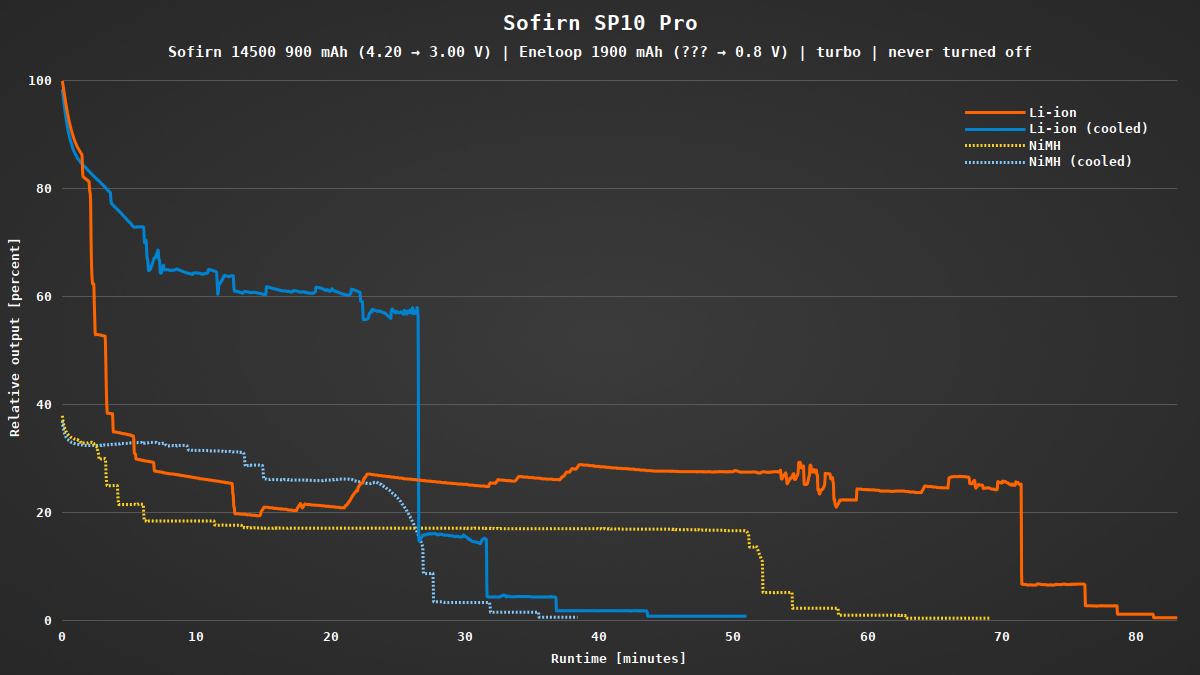

Here is a runtime measurement for Li-ion and NiMH, both on turbo after thermal calibration.
