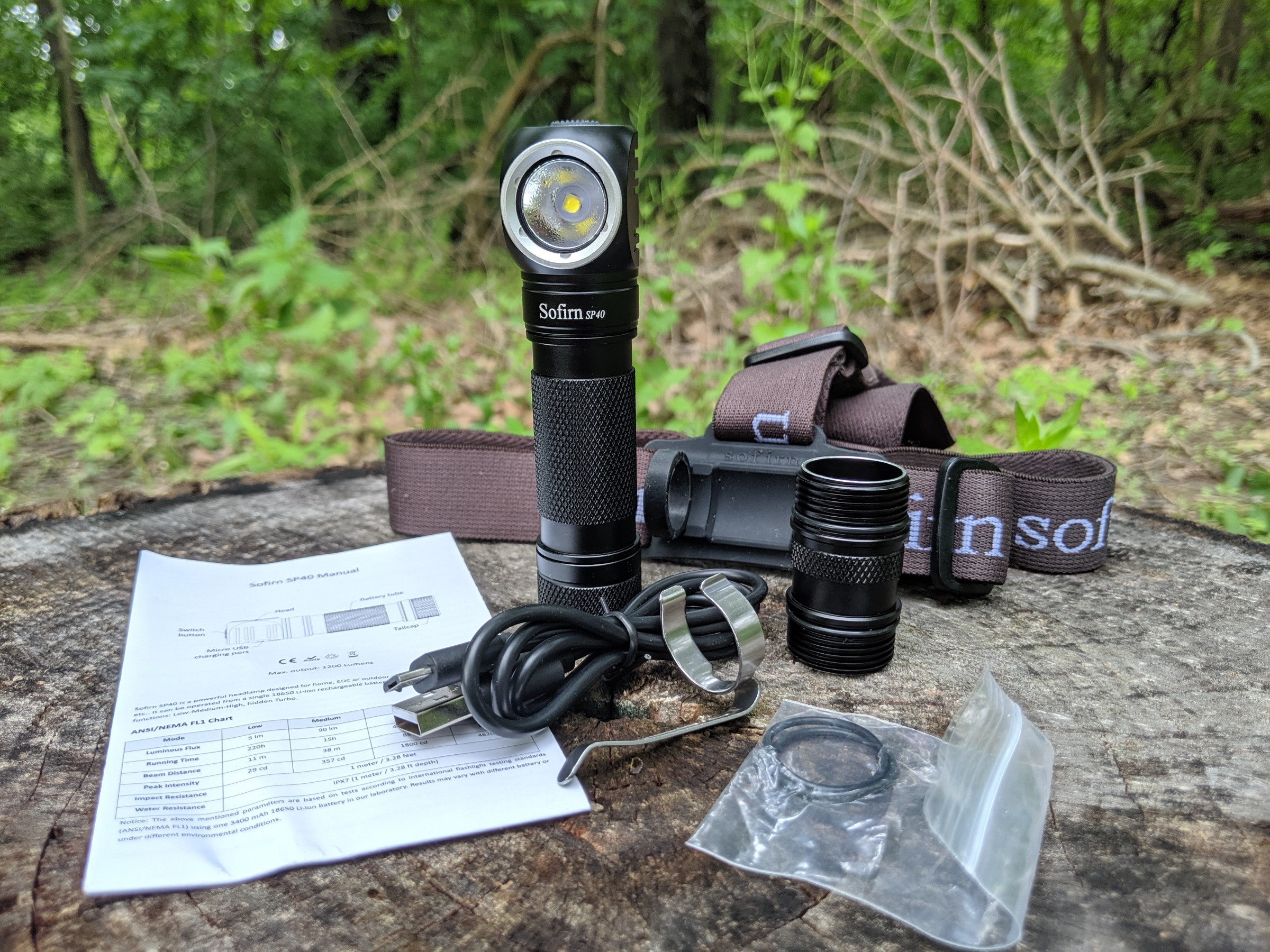

Excellent kit: it includes a 18350 tube, a well-designed three-way strap, a pocket clip, and a charging cable
