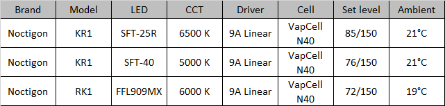

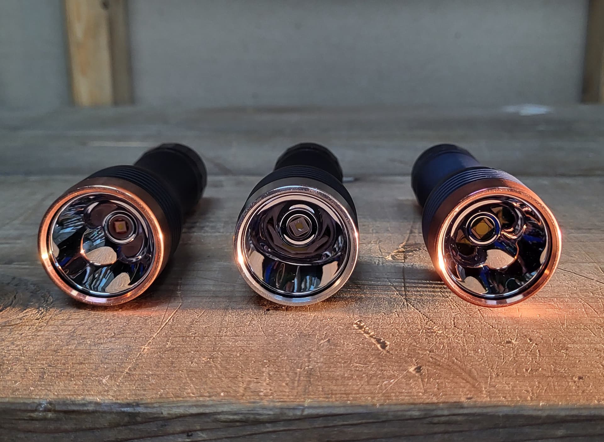

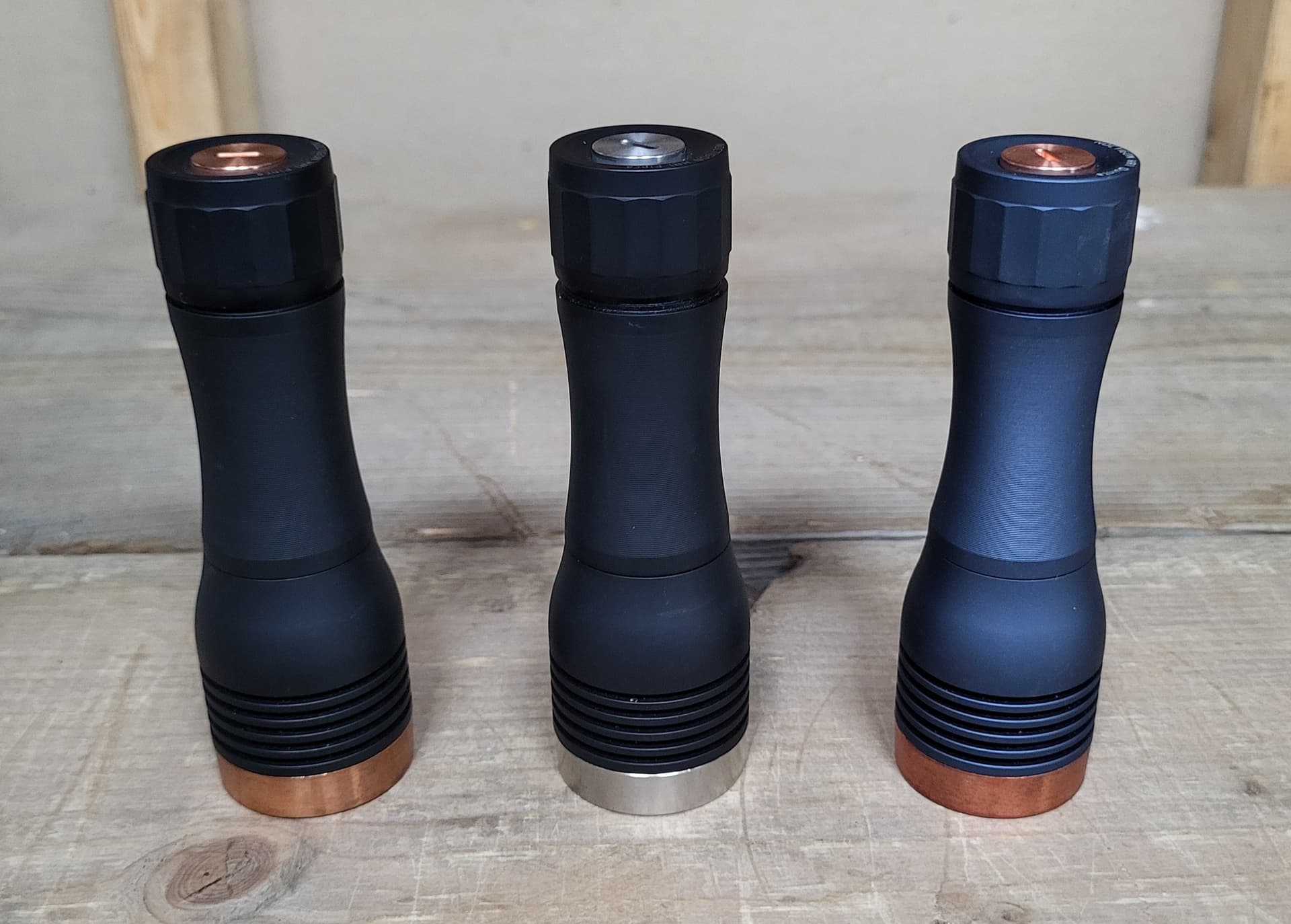

For round one, the spotlight is on three Noctigon KR1s, each hosting a different LED but all running the same 9A linear driver. Ceiling T° is set to 60°C. Here are today’s contenders:

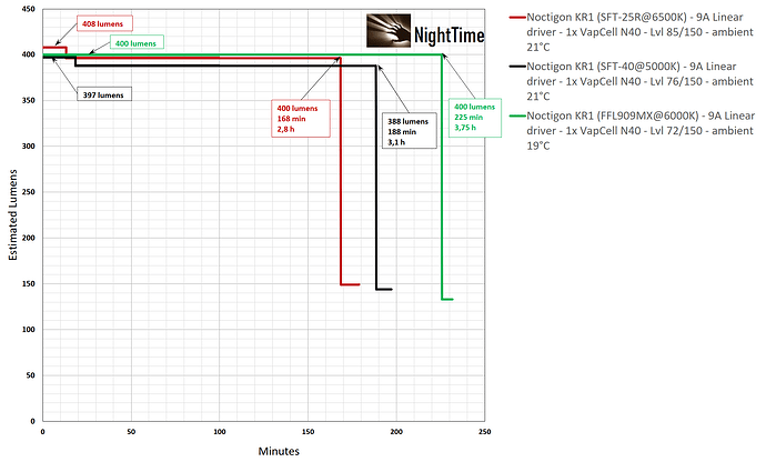

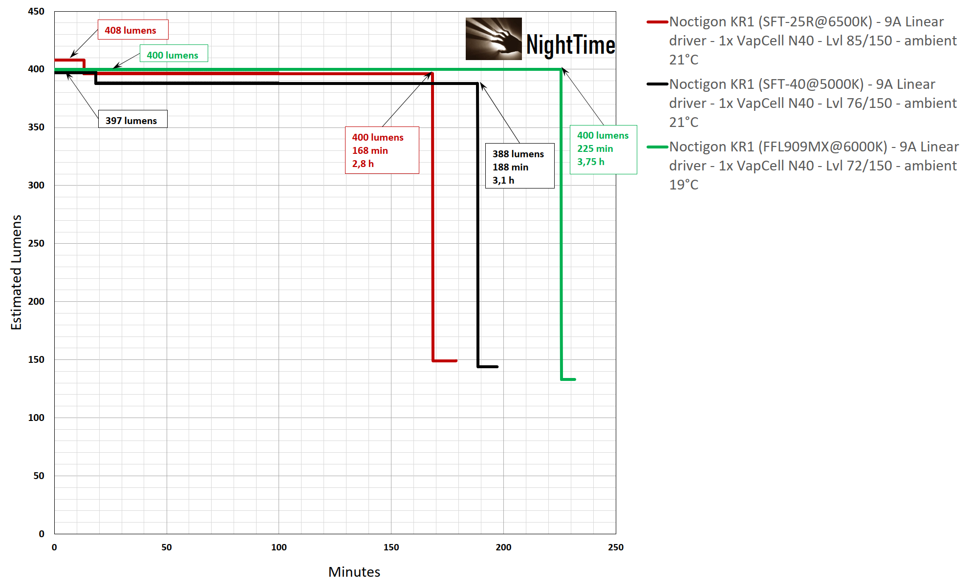

Were the results what you expected?

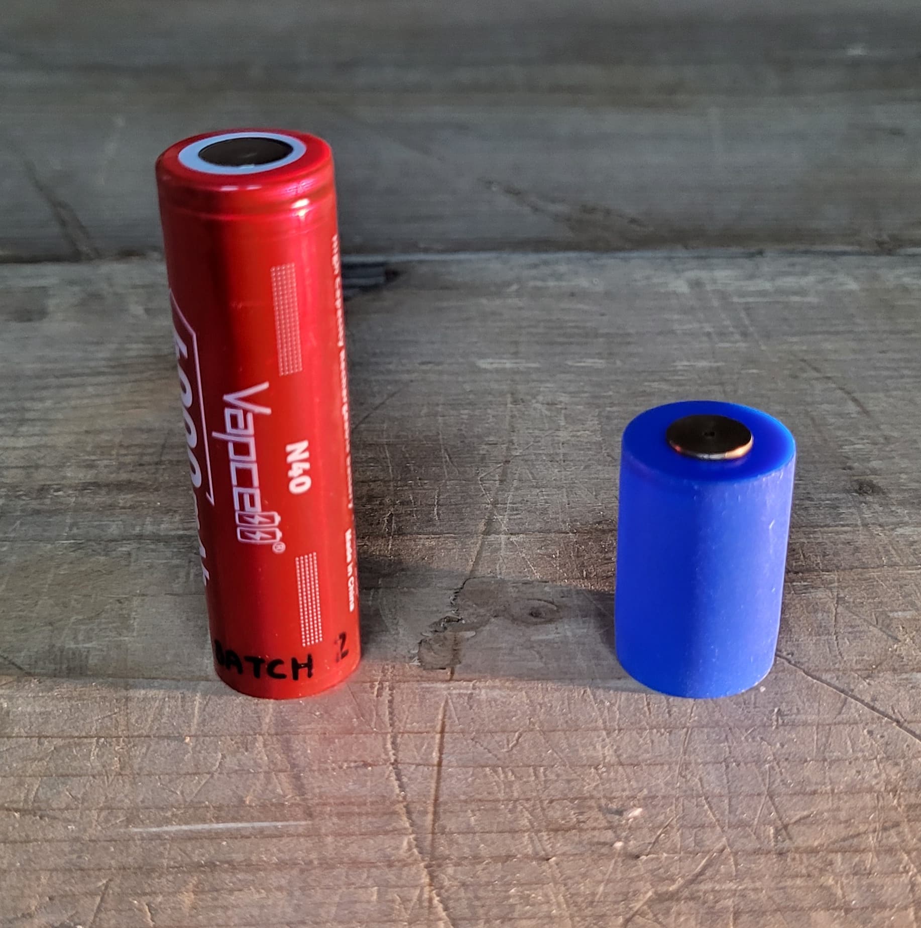

For consistency, I’ll keep using the VapCell N40 + adaptor in all my 21700 lights.
