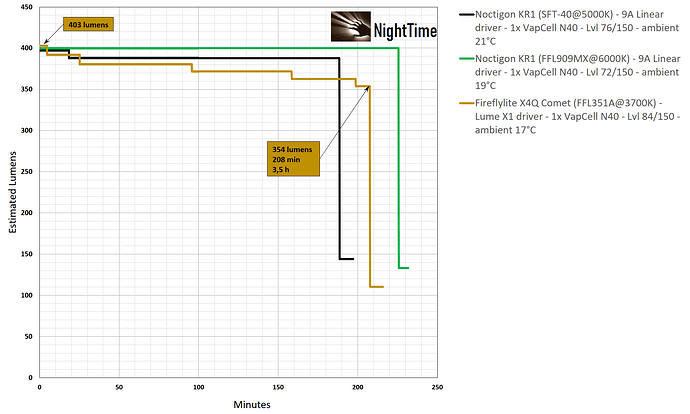

This time, we’re switching gears and color temps: spotlight on the FireflyLite X4Q Comet, hosting a FFL351A emitter at a cozy 3700 K, paired with a Lume X1 driver. You may have seen my previous review (Reddit | BLF), but this is the first time I’m testing this setup at ~400 lumens.

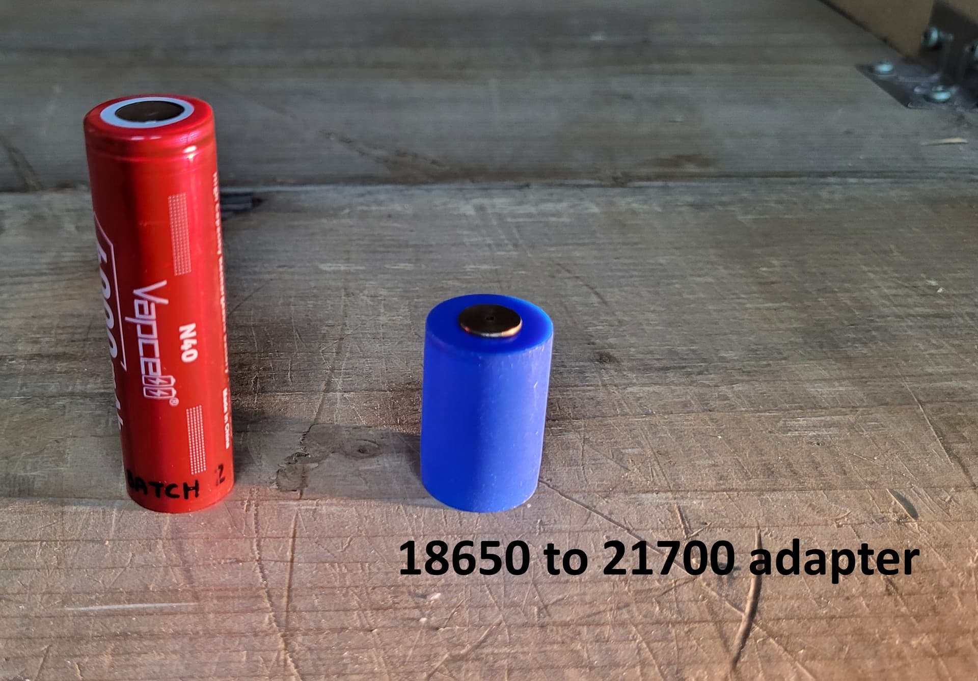

- Cell: 18650 Vapcell N40 + adapter (for consistency, even in this 21700 light)

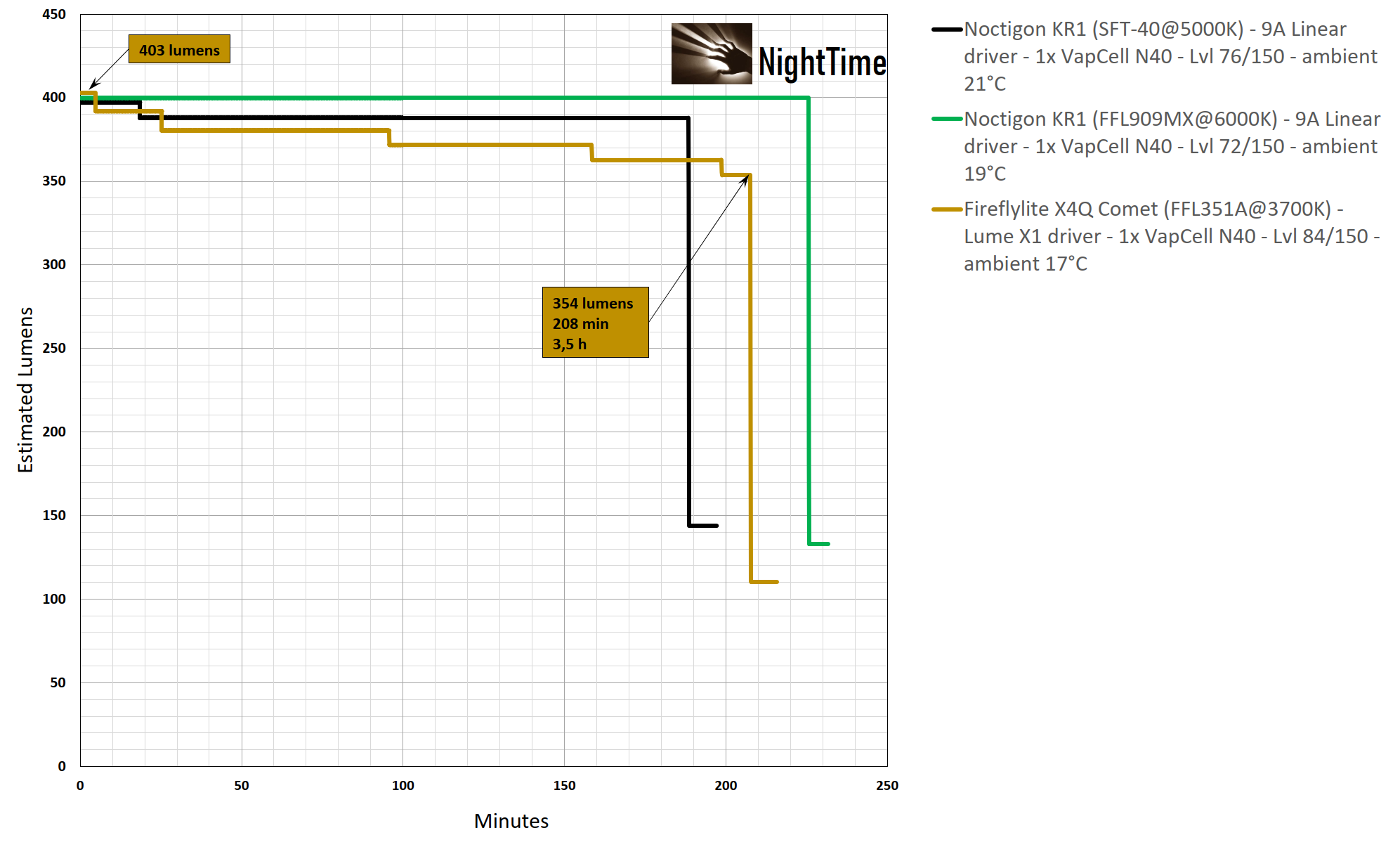

As expected with the Lume X1 driver, we see the usual behavior: output starts at 100% and gradually drops to ~88% just like in my previous tests.
Despite the much warmer CCT (2700 K lower), this setup holds its ground well, coming in not far behind the 6500K KR1 FFL909MX driven by a 9A linear driver.
