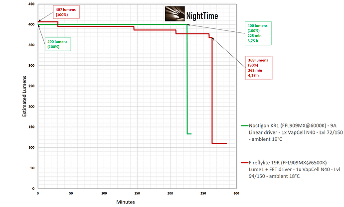

Brand Model LED CCT Driver Cell Set level Ambient
Fireflylite T9R FFL909MX 6500 K Lume1 6A Constant Current Buck Driver with FET Turbo VapCell N40 94/150 18°C

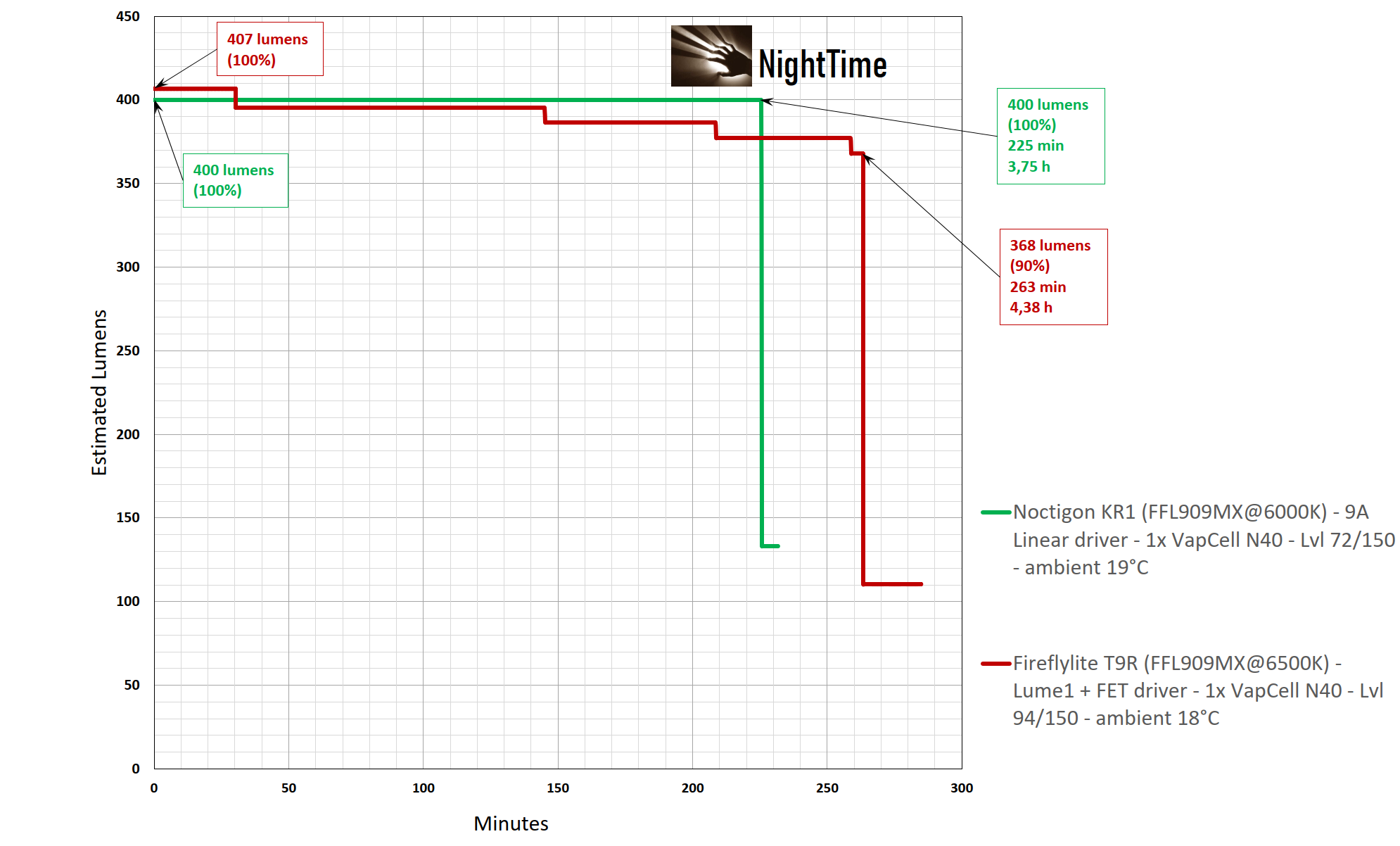

Click here for the full-size runtime graph

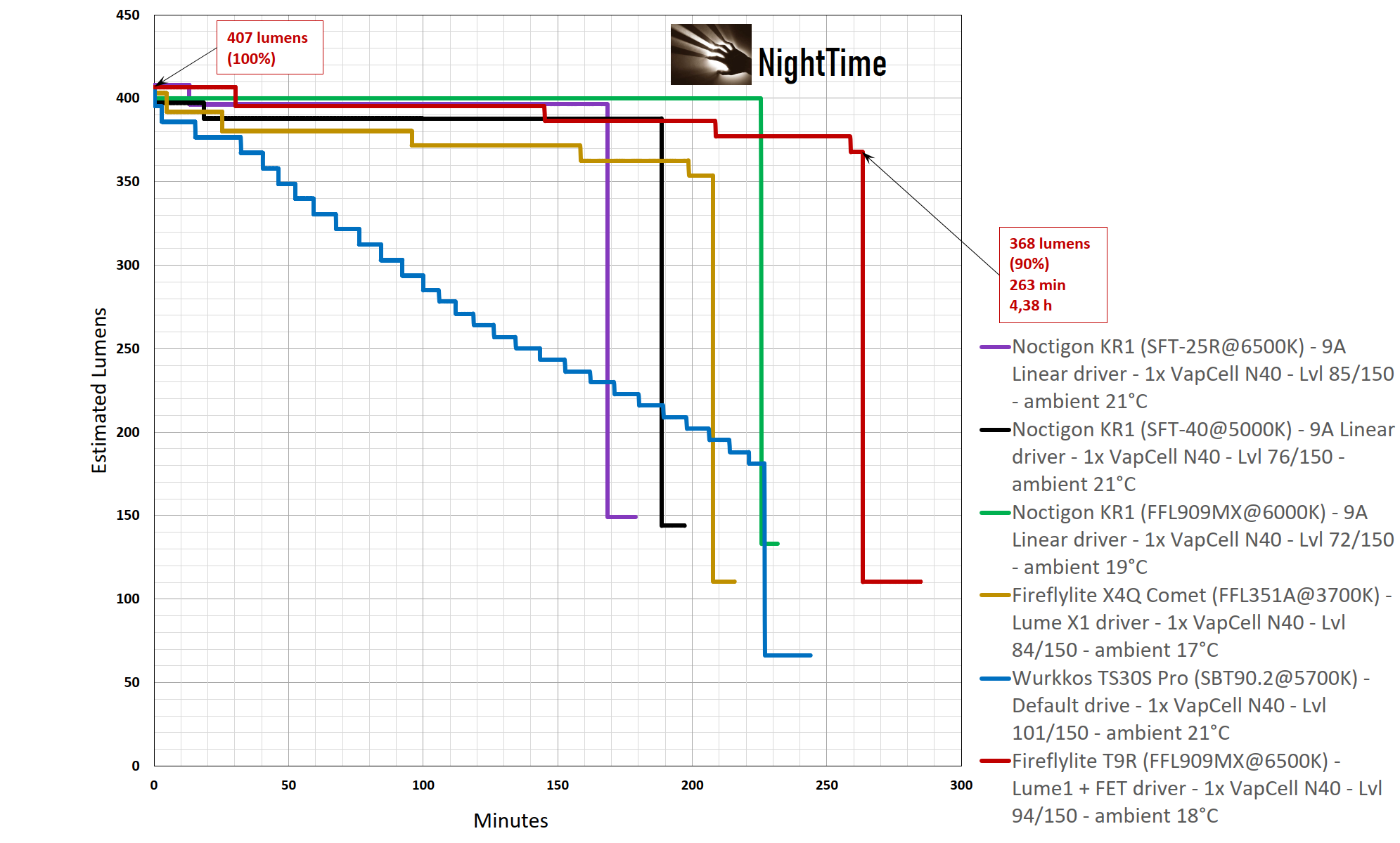

Click here for crowded all-in-one runtime graph
It’s tricky to declare a clear winner. Hank’s 9A Linear driver maintains an exceptionally flat output, whereas the Lume1 extends runtime by about 38 minutes, showing a steady decline from the 400-lumen mark to around 90% of its initial output before entering a sharper falloff phase.

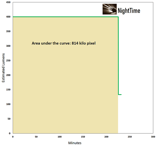

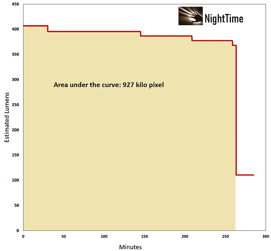

To help settle it, I measured the area under the curve using Paint•NET’s magic wand tool. You can see the results in the last two pictures above (or follow the links):
KR1 Area Under the Curve
T9R Area Under the Curve
Based on this metric, the T9R with the Lume1 driver achieved roughly 14% better efficiency in this round. Both lights performed admirably, each with its own strengths.
