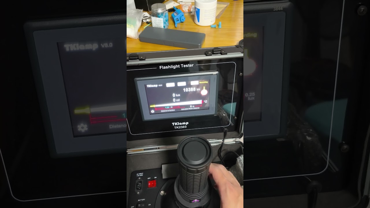

My DDH F8B has arrived not long ago and I measured a couple of things:
  1. It came with a 46120 battery in black sleeve (most likely Lithium-ion). Internal impedance is 1.2 milliohm (measured with my Yaorea 1035+).
  2. I measured level 1 to be 313 lumens and level 6 to be 11,000 lumens with my TK Lamp flashlight tester). Turbo is 42,000+ lumens (keep in mind that the battery is not fully charged).
  3. I will test the turbo brightness again once the battery is fully charged.

I measured 47,662 lumens on turbo which is not even close to the 80K - 90K spec. :frowning:
Edit: TK Lamp can measure up to 35,000 lumen so the measurement is invalid.
do you know anything about your battery? the 46120 batteries i’ve seen offer significantly lower total capacity/MDC/CDR when compared to a “standard” 46950. 48K is still a tonne of light, though!
ETA: did you get the lhp73b or “7016” LEDs?
I bought this from a Taobao seller and I specifically requested for the NBD7016 LEDs. I think my sphere can only measure up to 35,000 lumens so my data is unreliable…
Once you get past 30k Lumens it gets tricky to measure without a large calibrated integrating device (I use a 50 cm sphere). Still, be prepared to be disappointed since Chinese Lumens are not the same as everyone else’s Lumens unless you buy from a reputable Chinese brand. Amutorch, Haikelite, Nightwatch mostly perform at about 30% to 50% of advertised.
If you have a reliable lux meter, this shouldn’t be a problem. Measure the same light on a low output in both the sphere and the lux meter to get the constant of proportionality between lumens and lux (at some fixed distance) for that light. Then measuring lux on max lets you deduce the lumens by just multiplying that constant of proportionality.
