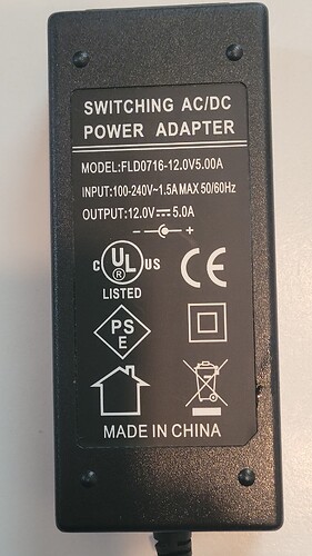

I just got my 2 x su-2 and one S4 Plus replacements. They didn’t give me power cords. I have some extra from S4 plus. The one su-2 that malfunction the worst I tossed the cord. I’m going to send you pictures of the su2 which is the smaller power supply and the S4 power supply. Is it safe to use the S4 power supply for the su2? Thanks
Here is another one that came out of an old su-4 box. The first one …Yellow print that I believe was su-4 says 1.6 amp? All the others say 1.5 amp
The power supplies should be ok.
The SU2 and S4+ might have the same design as before unless you’ve received a new version of each.
I emailed them. I have no idea if they have the same design as before they had to make improvements so it doesn’t smoke again.
Thanks
If you look at the photos closely the larger power supplies for the S4 Plus have 12V/5A and SU2 5A has 12V/ 2.5A. Does that extra 2 .5 amps make a difference? It must in some capacity I don’t know enough about Electronics to determine that.
It’s fine to use the 5A PSU since the charger will only draw what it needs.
Thanks… that makes sense. I hope it works well.
