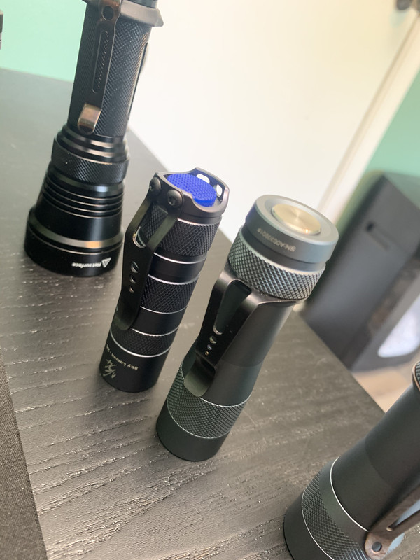

Also swapped Osram W2s into a FW3A, my first emitter swap. I love the W2 emitter. Love the torch labs clips too. Their 1” clip just took a little sanding on the inner diameter to fit and the Convoy had to be drilled and tapped. The convoy next to the FW3A was modded by Skylumen with an sbt90.
Looks good :wink:
BTW, are you using Carclo 10507 or 10511?
:+1: 10507, I think its my favorite.
Nice, it will also give it some throw! :wink: Well done!!

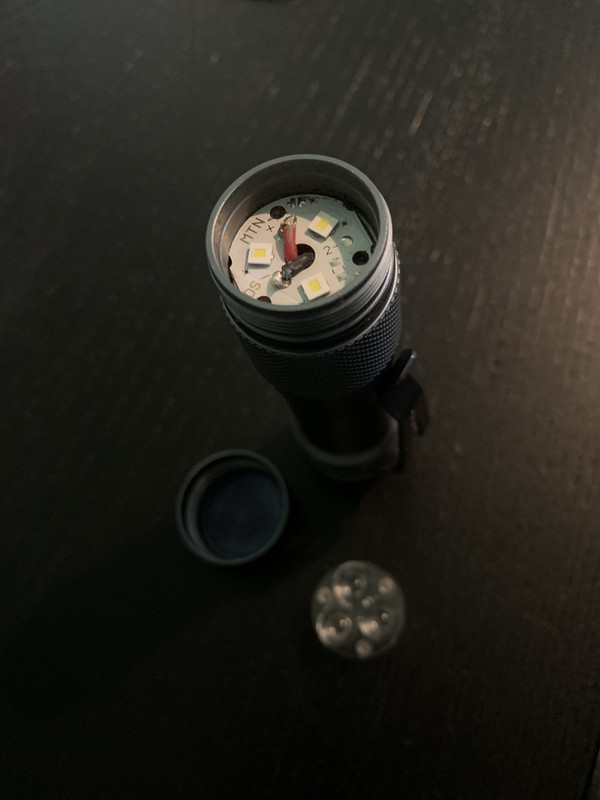

Finally have a warm thrower. XPL HD 3000k in a Astrolux C8. Too lazy to slice it so it’ll stay an HD. And it’s not as warm as I thought it would be. Kinda disappointed but also happy about it.
I was organizing pics and noticed this solder problem.
Thinking it may cause this.
So I purchased this to maybe prevent a repeat.
