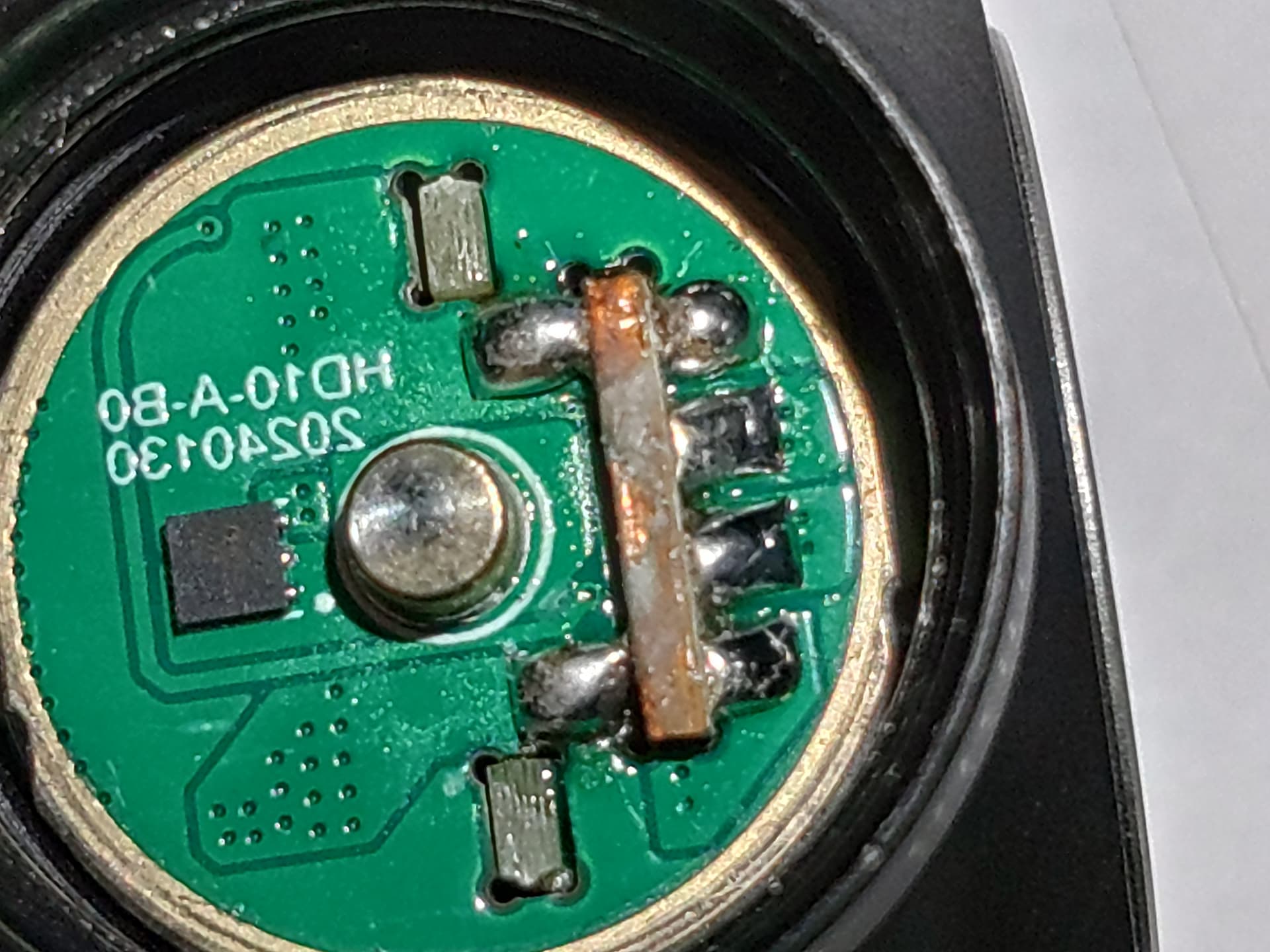

I did some voltage checking with the tube off but plugged into USB. The four solder joints on the right in the picture are negative so incidental contact with those two top and bottom ones may not be a problem. The surface of the green PCB board does sit slightly proud of the brass outside ring. So the thick end of the tube is definitely going to press down on some of those tracks that get right out to the edge of the green PCB. I don’t see that as being a good thing and like I said, Wurkkos took the extra time and effort to ensure that the tube did not touch anything green.

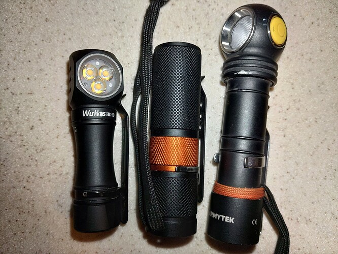

I know a lot of people like 14500 lights. And eventually some people may be able to use this one. For me it’s too small except for very limited close up use. I did use it for five nights as my nightstand bathroom trip light. But I missed the 3000k and wider view of my armytek. I also took it on one 10 minute hike on a trail in pitch dark while mounted in the headband. It was usable but again I missed the above. And I did carry it for a week in the change pocket because I don’t have any other good pocket to commit it to with a clip or in the bottom of a pocket. So even if I could trust it and it was available in 3000K I don’t believe I would ever actually really use it other than potentially as a nightstand light or maybe close up task headlight. I would never carry it.
Here it is with a modified tube and a convoy clip with the body bands bent tighter.
I carry the other two lights daily. The S6 short tube with a 3000K SFT40 is in a horizontal belt pouch. The armytek from killzone with 3000k is clipped in a left side cargo pocket.

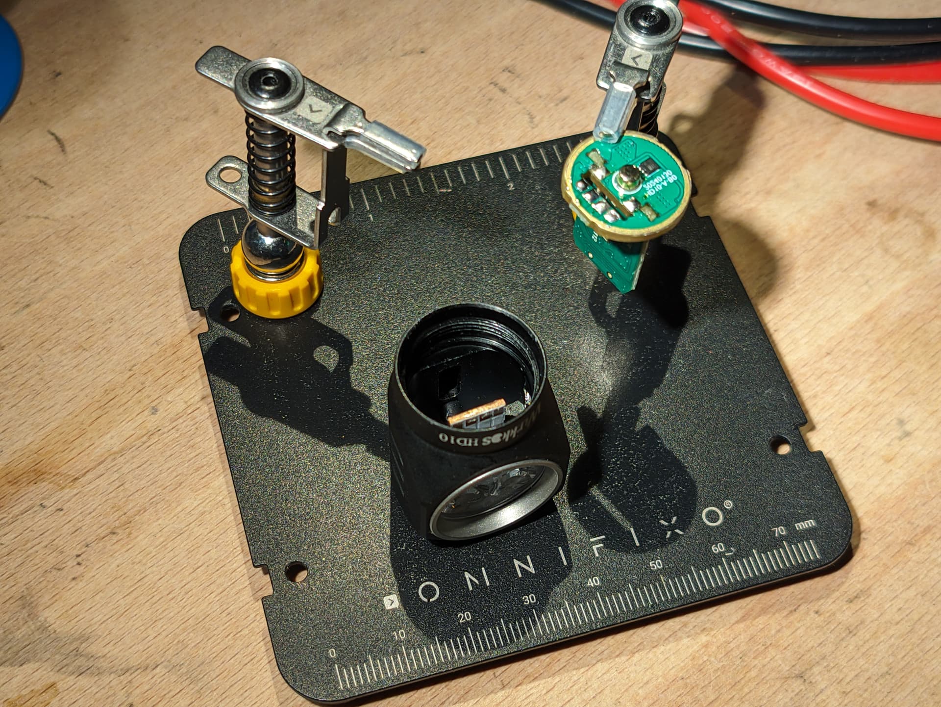

Fine, you convinced me, I cracked mine open. Full analysis will follow in my review thread once I’m done :slight_smile:
@Oli you can spare yours :smile:
Actually, with some solder wick and a decently powerful iron it’s pretty easy to open non-destructively, I’m sure I will get it back together and it will look as good as new once I’m done!

Not easily, the controller and everything but the FETs and the 7135 sits on the vertical small PCB. It would need additonal contacts from the vertical to the round PCB to expose them properly :confused:
I will probably solder a tiny cable breakout to keep them accessible after reassembling.
Do they have the firmware for this published anywhere? If not I have to reverse engineer the whole PCB to create a Anduril target myself, which sounds like a ton of effort. II will try, but that might take a while. First I want to reverse engineer the basics of the power stage out of curiosity :slight_smile:
To get the LEDs out you need to somehow pry the bezel off, I do not see that happening without mechanical damage :confused:
