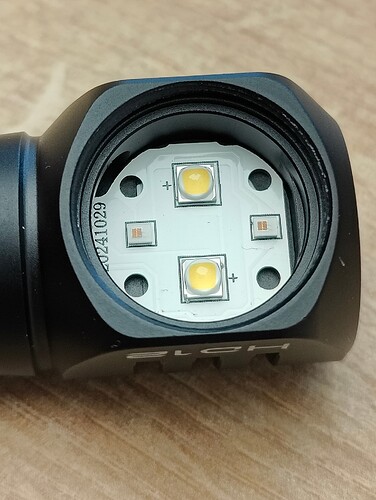

Can anyone identify these HD12 LEDs?
Me Opple LM4 says those are CRI75 LEDs, but I don’t put my trust in this device… Tint seems legit though - reads 4662K in low mode with DUV 0.0118
Maybe these
http://en.latticepower.com/NewsView.aspx?id=452
The photo on the page shows different corner marks, but check out the photo in the datasheet.
Looks like the main LEDs are connected in series, so they are powered by a boost driver indeed.
Also I wonder how one can extract that mcpcb? Where are the wires?
That’s interesting, I was sure they would just use CSP LEDs on this light, just like in the TS10 and HD10 but somehow they opted for 3535 LEDs. Can you send pictures of the TIR optics?
That Lattice power LEDs photo from datasheet matches these perfectly :+1:

Are these the LEDs?
Has anybody had a chance to measure max current draw on turbo and/or high?
I found this on TLS by @flashoholic:
The white LEDs is lattice power KH 5W 5000K, red LEDs is lattice power HFL1-R

It is relatively easy with round nose pliers like those from Convoy.
I have swapped the emitters for 519a and it’s a bit tricky to disconnect the MCPCB from the controller board.
Thanks. Is there a way to also remove the switch? The holding ring doesn’t seem to have indentations - is it pressed-in I wonder? I was thinking of removing it to properly lubricate the threads and gasket as well.
It’s press-fit. I did not pay special attention to it but I noticed that the button remains in place even with all electronics/internals removed. I cannot imagine any intervention to improve it in a meaningful way.
You must remove all the internals and push the switch from the inside, I’ve removed it this way.
Cheers! The switch assembly has a gasket I imagine?
