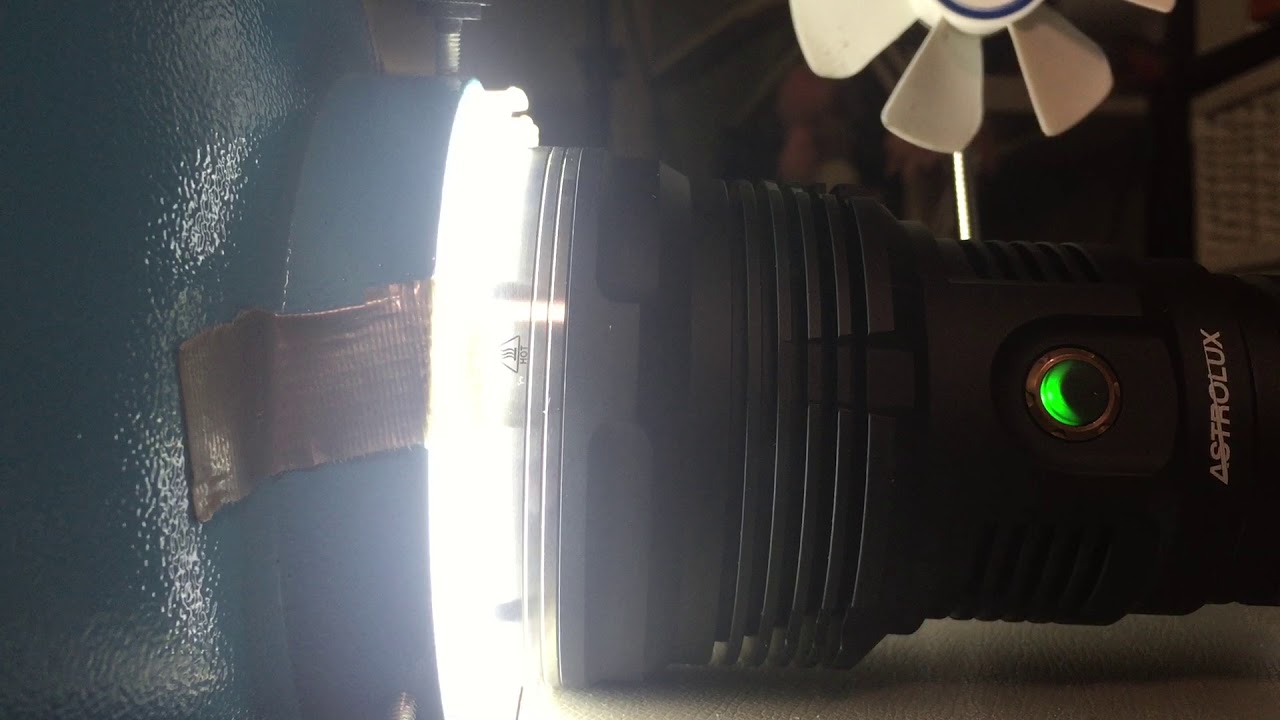

Thanks to an active temperature control the light heats up to about 50°C on turbo and steps down in room temperature without cooling. The highest surface temperature I measured was 53°C at a couple of minutes after the stepdown. On the lower modes the light doesn’t get very hot (46°C on high).
As the light heats up on turbo (or cools down), there’s loud crackling noises from the bezel/lens.
