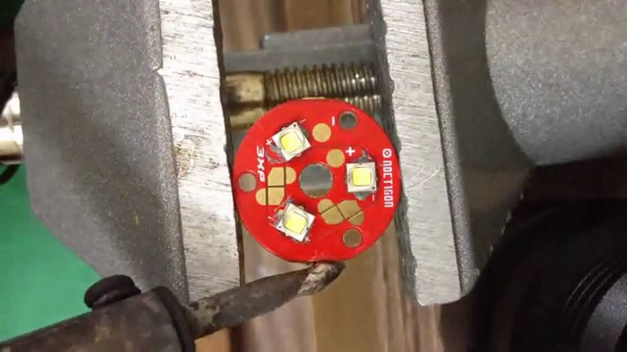

I had not much time, my heatblock with well-controlled temperature takes half an hour to warm up and this worked:
Yes, that’s how I do it. Initially I used too much heat and the LED and board would smoke. Lol! It’s always so nice to finally see the LED float and shift into place ;D
Same here. Had to go through quite a few smoked PCBs though. It heats up too fast.
Seems risky. Easy to heat it up too much.

did you put solderpaste on the noctigon?
While camping, I used a propane lighter and a pair or needle nosed pliers to reflow with perfect results. As the mcpcb heats up, just hold the flame further away and then remove it when the solder liquifies.

I also have done this a couple of time, works really fast…I found out that it is easier with noctigons than sinkpads because sinkpads easyly loosens the top layer if you apply to much heat.

Ive done 4 or 5 with a lighter and its actually quite easy.
Not arguing with you or saying your wrong, I’m sure we all have different experiences and techniques, but I’ve foind the opposite. SinkPAD ’s can handle the heat better than Noctigon.
I reflow on a glass cook top.
it was pre-tinned by a former led.
I was curious if this would work and placed a phone camera next to it. It must be very easy to kill a led this way but I was fast enough :-)
