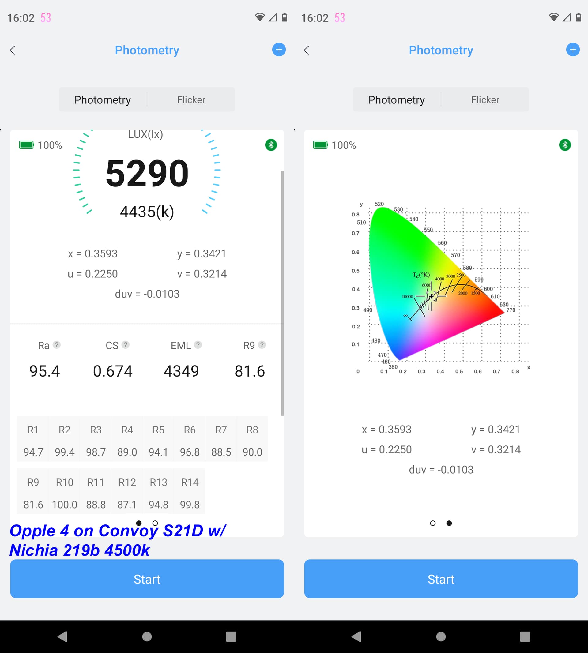

. I’m thrilled. First on the block would be of course Convoy S21D with legendary 219b 4500k. Will post pictures.
Simon’s Nichia 219b 4500k in S21D. R9080 LED and now we finally get to see it.
Triple digit negative Duv, minus 103, as expected of the king of rosy tint.
The Opple 4 slides more easily and clicks into place more “clearly” than my 2 Opple 3’s.
(I merged two screen pictures into 1.)

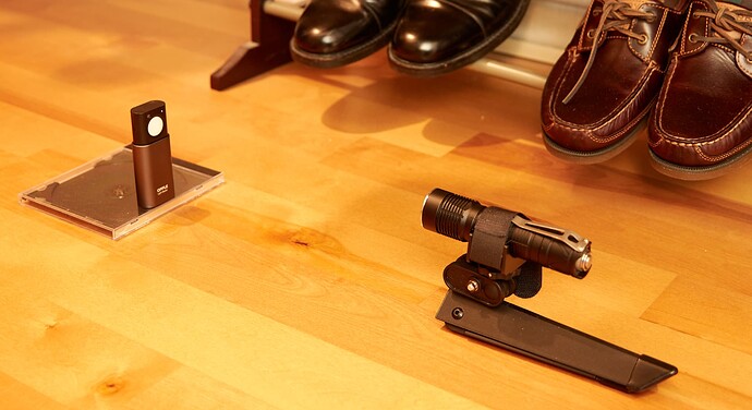

Duv reading is now instantaneous and continuous so I fix light and sensor in place and could watch Duv drops as the light heats up, especially dramatic with Nichia 519a. And rises when output drops. (Sorry about the shoes; I do Duv test in my closet.)
