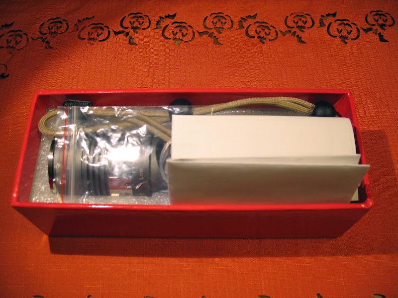

The torch arrived in great condition. The box is very thick and sturdy with the "Darth" name printed on it.
Inside the box we find the folded one sheet manual, a spare o-ring in s small zip-lock baggie, a very nice lanyard and, of course, the Darth itself tucked snugly inside it's cut closed-cell foam padding.
Here is everything laid out...

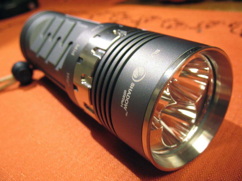

The head of the light is etched nicely with the Black Shadow logo and the Darth name. The first thing you notice is it's heft and it's compact size. The next thing you notice is the great machining and overall quality feel of the light. My example arrived without a single visible flaw.

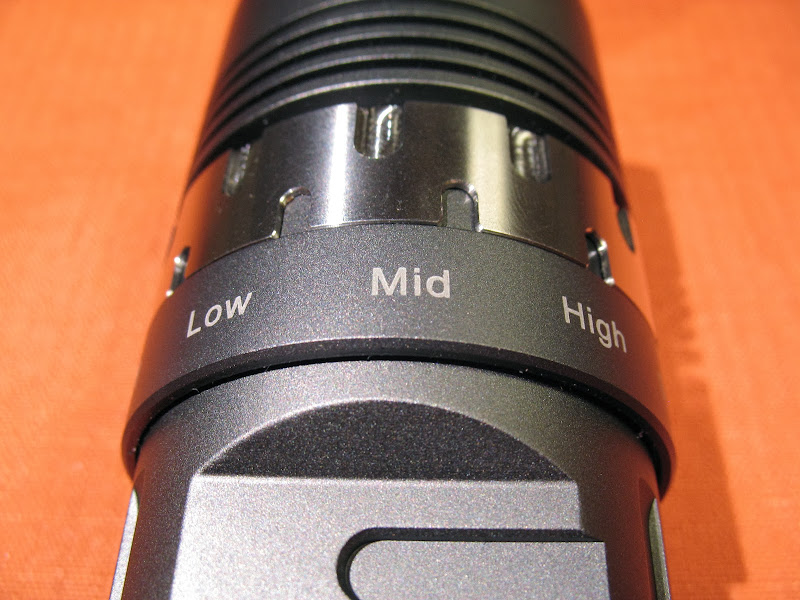

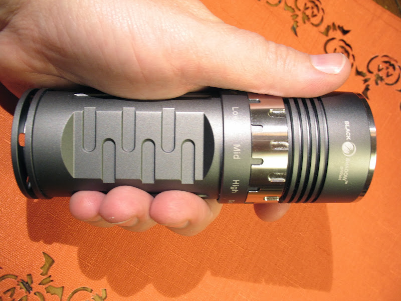

The magnetic control ring operates smoothly and allows you to quickly and easily spin to the mode you want with just one hand. Each mode snicks into place with a solid indent but can be spun from one end of it's cycle to the other with a determined flick of your thumb. Each mode is nicely laser etched into the surface of the ano.
Here you can see how nicely the surface and the fins are machined. Everything is crisp without a trace of sharpness. The only machining marks that are visible are in the grip notches of the stainless steel control ring.

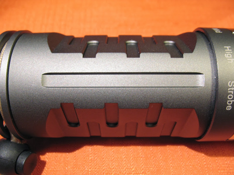

The main body is carved from a block of aluminum into 3 main facets. The grip grooves continue the styling of the control ring for one of, if not the most, unified design styling as I've seen on any flashlight. It is truly an attractive pice of equipment and as much eye candy as it is hand candy.
Here you get a real good idea of the quality of the machining and anodization on this torch. It feels very good in the hand!

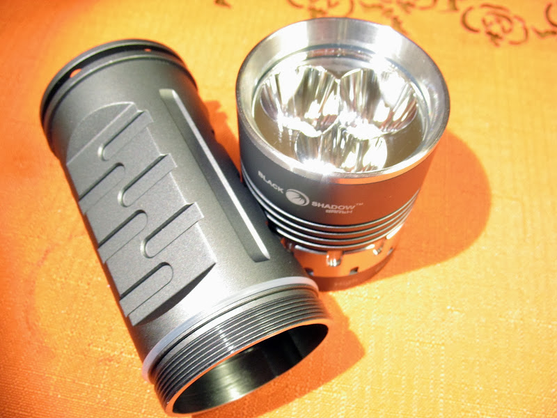

Unscrewing the body from the head reveals as much attention to detail as there is on the outside.

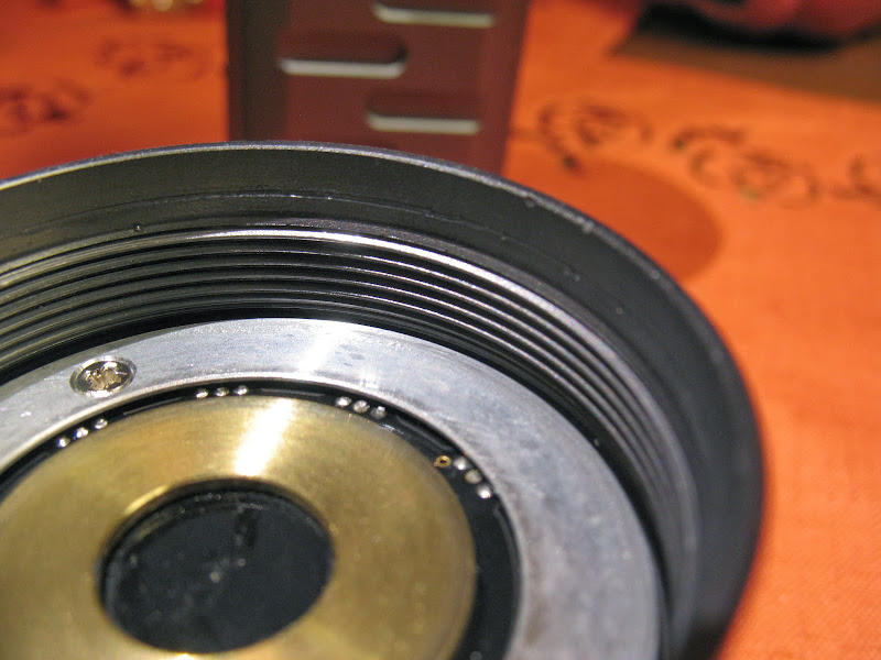

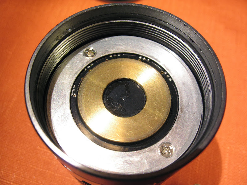

A look at the inside of the head reveals a driver that is held in place with screws. Not sure why, but I didn't open this to take a peak inside. I will have to remedy this. The thing that made a huge impression on me is the anode contact ring. It's about 1mm thick and made of brass. It resists wear from the cells scraping across it when the head is tightened or unscrewed. The SkyRay King, in comparison, has an anode contact ring printed onto the PCB like a circuit trace and quickly shows where even after just one tightening and removing of the head with batteries installed. While this leaves the long term durability of the ever popular King's contact ring in serious doubt, the Darth, on the other hand, leaves me feeling confident that it's contact ring will easily outlife any of us.

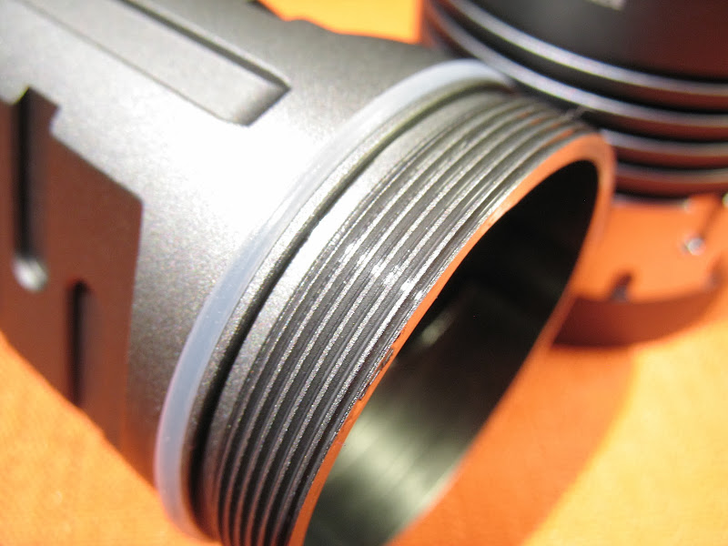

Here we have a closer look at the beautifully cut threads on the inside of the head.
Here are the wonderfully machined and anodized threads on the body. Ground contact from the batteries is made through the lip of the body contacting the bare metal of the outer driver contact ring. While lockout isn't needed on the Darth due to the switch, if you were to pack the Darth for travel in either a bag or a suitcase you could unscrew the head just a hair and have no worries at all about the switch or mode ring accidentally turning the torch on and overheating while unattended. Peace of mind is worth a little extra and the Darth provides it.
The o-ring on the body is possibly my only complaint about the entire light. While it is thick and provides a great seal from moisture penetrating through the body/head joint, it is overly thick and makes it very hard to twist the pieces while threading them together or taking them apart. When attaching the head to the body you have to engage the o-ring and place pressure on it. Next you have to run your fingernail along the o-ring and press it into the head a little, tight a little more, run your nail around the o-ring to press it further under the head, tighten a little...and so on until the o-ring is safely under the lip of the head. Once it is under you can continue threading the head onto the body until it is fully threaded. While the light did arrive with dry threads, adding lube to the threads and o-ring only helps with this a little as the o-ring is just too thick. Not working it under the head lip with your fingernail runs the very likely risk of pushing the o-ring out of it's groove and rendering it useless. This is something the Black Shadow folks need to address. Fortunately it is only a problem when charging/swapping cells but it can be a PITA when it could also be easily resolved with a slightly thinner o-ring. One more note, the o-ring used on the body is the same as the one used for the lens gasket. With the two locations being very close in size, this means the body o-ring is not as tight as it should be.

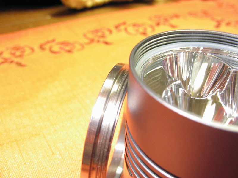

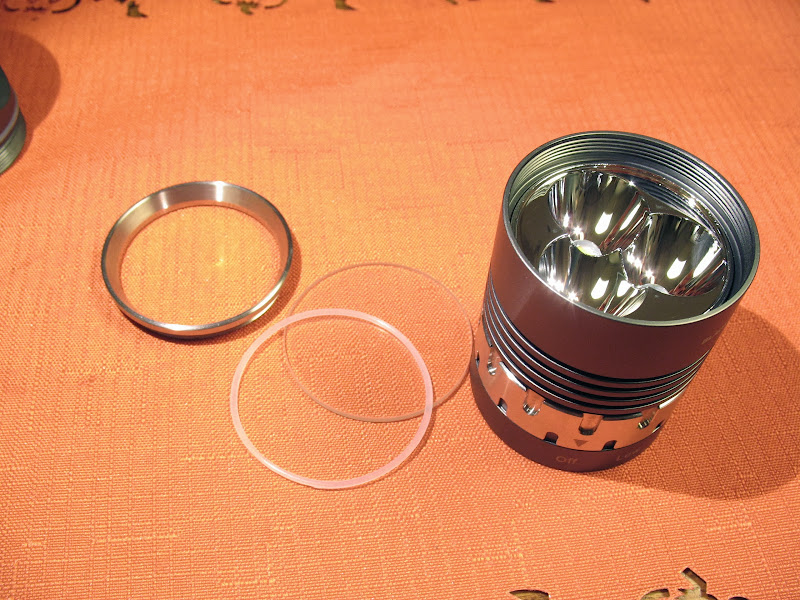

The stainless steel bezel is also nicely machined and threads easily onto the head of the light. All threads are, again, cleanly cut. I will say that the threads on the bezel are a little loose compared to the other threads on the light but once the bezel is seated it is snug and stays put tightly.

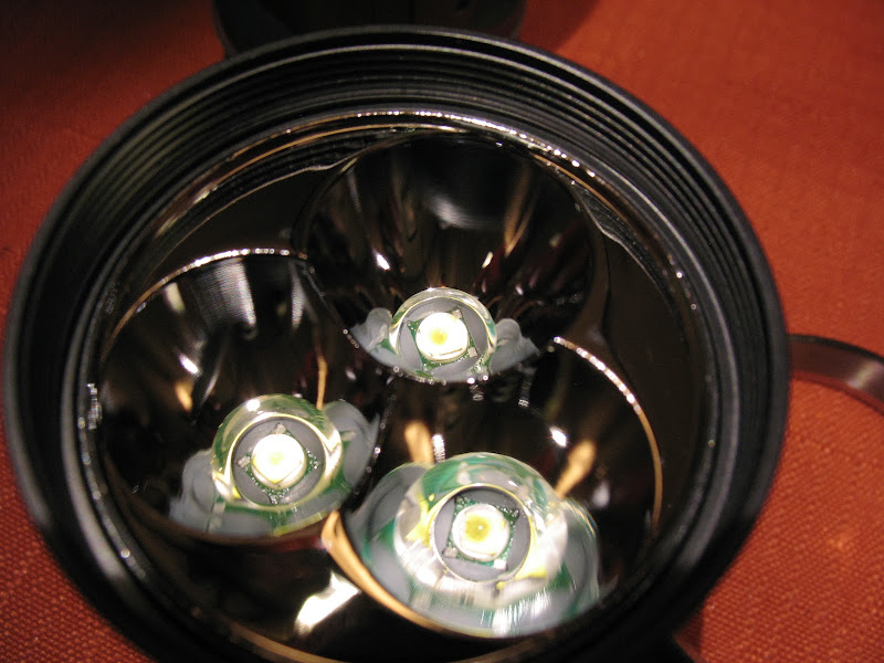

All 3 emitters are perfectly centered. The reflector is clean and free of any defects. The overlapping reflectors use all available space inside the head.

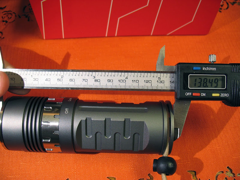

Overall length is 138mm

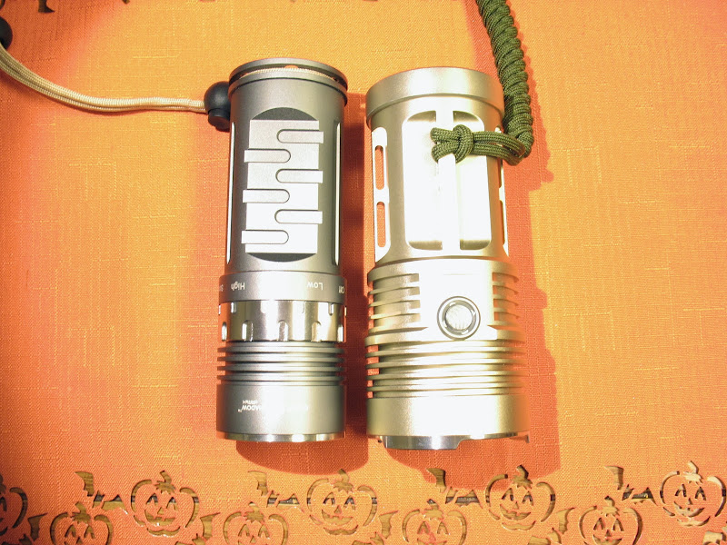

Here I have the Black Shadow Darth next to the SkyRay King. While the Darth is a touch longer, it is also much smaller in diameter and far more convenient to pocket.
