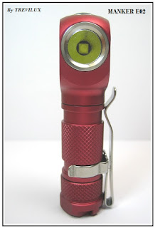

Review: Manker E02. 1xAAA - XPG3 - L shapped
Manker E02; A very small flashlight with "L" design, which works with 1 battery aaa preferably a rechargeable type NiMH to get all its potential .... which incredibly offers us a Turbo mode of more than 200 lumens, the first with this type of Battery exceeds 200 (at least of the ones I know). It has an incredible and complete interface as Manker already has us accustomed, with 4 normal modes of use (plus 3 special), the lowest of them "Moonlight" fully customizable with 21 power options available to choose from the "engineering" Configuration.
I present a model in red, but there are other colors available.
Manker E02:
  • Led/Reflector: XP-G3 (also available nichia 219C) / Reflector OP
  • Battery: 1xAAA For optimum performance recommended a good quality NiMH.
  • Modes: 4 Normal (Moonlight/Low/Medium/Turbo) + especial (Strobe/SOS/Beacon)
  • Interface: Electronic switch (head)
  • Link: luxlinternas.blogspot / forolinternas.com
  • Link Ebay: Ebay E02
INTRODUCTION
Manker has been a time between us, always emphasizing by design and by power, besides very good regulation in all its models. Now with this incursion into the "L" lights, through a supercompact AAA, with the best Turbo mode that I've seen for this type of battery, surpassing 200 lumens in Turbo mode, with a very complete interface, a configurable Moonlight mode with 21 power options, they have surprised me again.
The E02 includes a quality lanyard, 2 spare Orings and a great clip that allow 2 different Powerful tail magnet that allows the flashlight to be placed on the metal surface at any angle without problems. Being a version of "Pre-production" has not included user manual, but presumably, i can suppose it will be included in the retail version.
Let's look these possible placements of the clip:
The Manker E02 is a very small and powerful flashlight, it is not the lightest in this size, but it is appreciated if we consider that it will offer more than 200 lumens in Turbo mode. Let's see the measurements (32.7 grams only the flashlight, if we add the clip 3.5 gr, and plus the weight of a battery type NiMH, the set will be 47.7 gr.):
73 mm is a very portable size, so that we have a clear idea, compare with 2 other flashligths L shapped, one AA the HL50 and another 18650; the Nitecore HC30:
