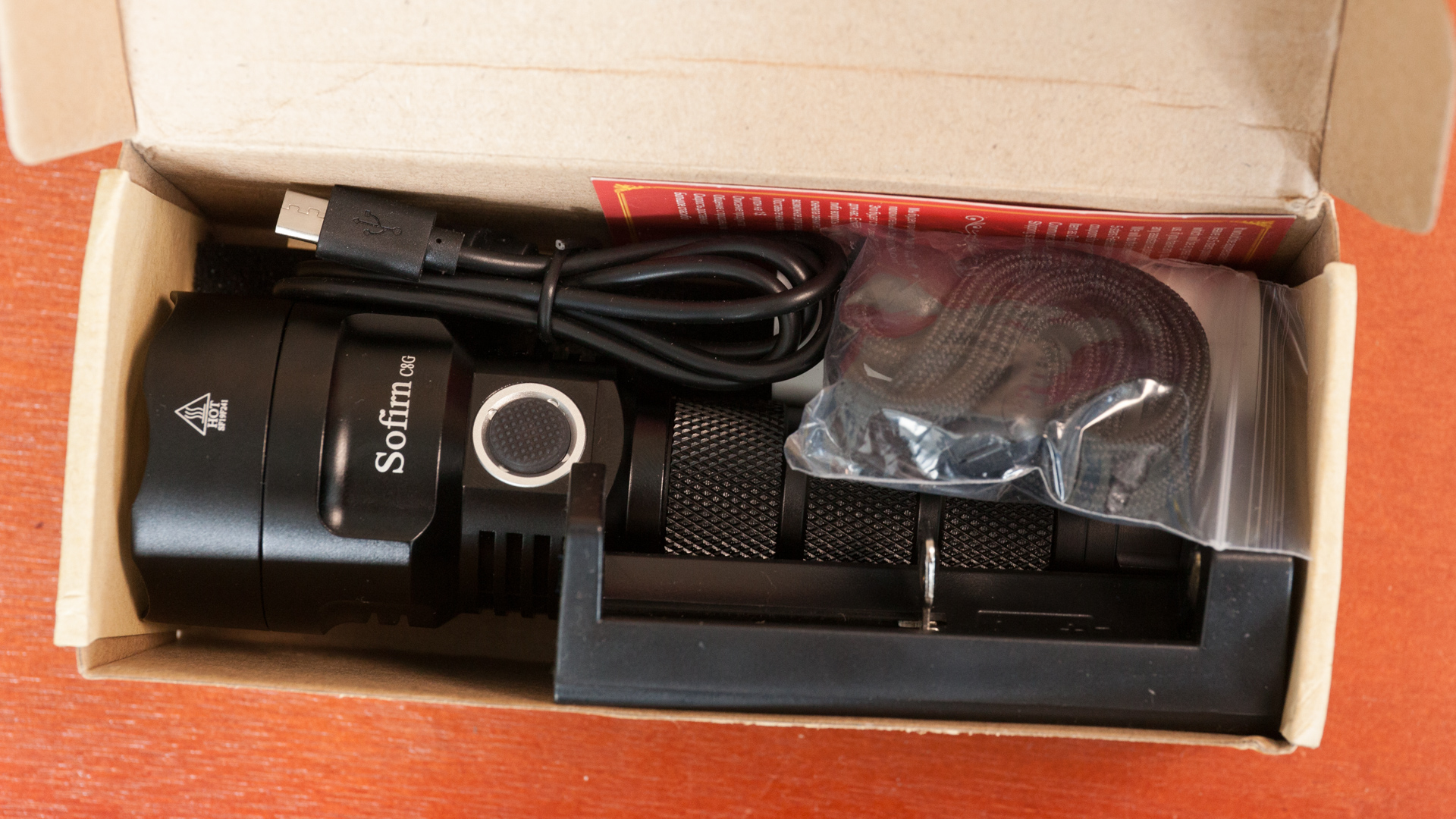

PACKAGE AND APPEARANCE
Everything is as usual: a beige cardboard without the slightest hint is of design. So, it`ll not be good as a gift. But when it is bought for personal use - who cares. Inside is all that is needed: 18650-21700 conversion tube, lanyard, pair of o-rings, manual. If you take full set, then you get 21700 battery and charger as well.

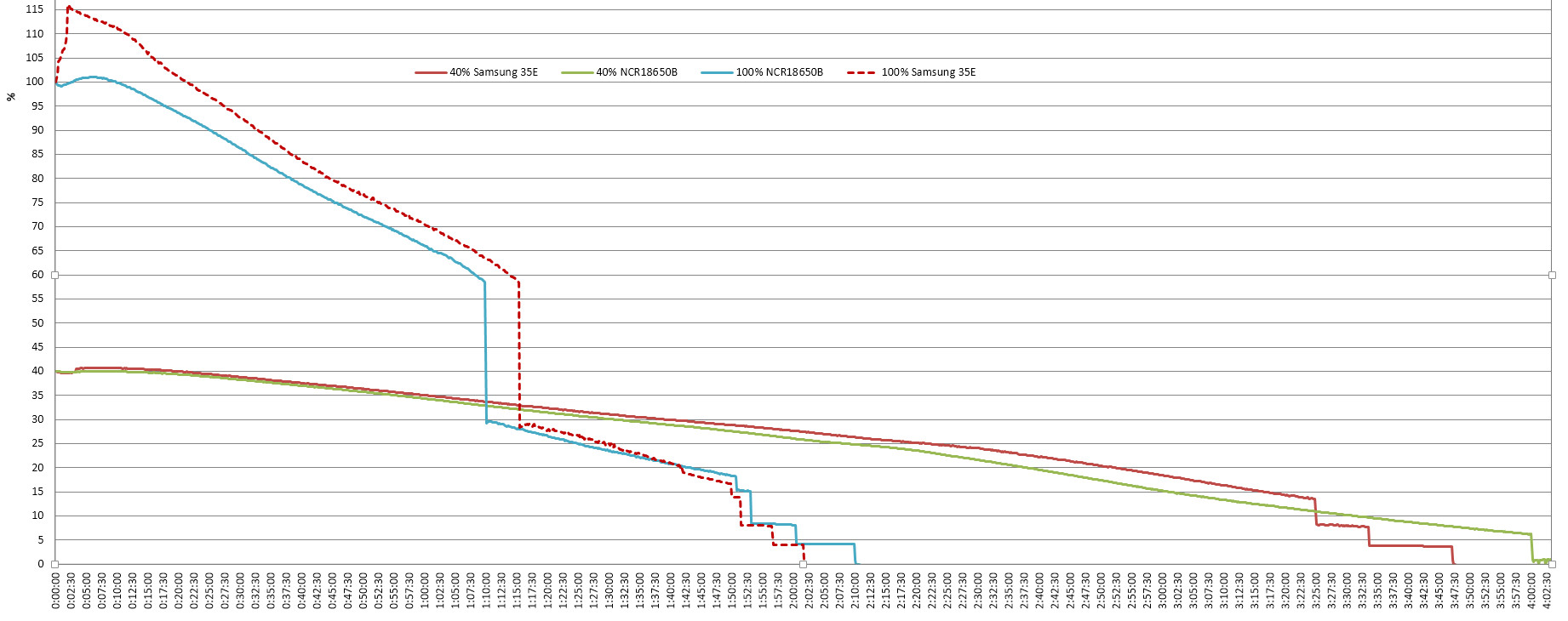

Manual declares thermoregulation. Dont believe everrything here. As for rutume , in fact, you get this:
1) Turbo is long lasting , it will last enough until initial stepdown to see everything around (and then, actually, in after stepdown level).
Despite the fact that turbo can be turned on time after time, this will not work with bare hands, because the body is heated to a temperature painful for the hands. Wearing gloves and wind blowing will make this easier.
Accordingly, in the latter conditions it is possible to count on a higher brightness. Brightness drops to high from turbo when Sofirn C8G has some cooling. Without it there is a stepdown to some lower level. The difference will be palpable, like 20%. As you can see, this logically translates into a difference in the rutime as well, 2 hours before next stepdown against 3 hours.
2) the simplest calculations show that the promised two thousand lumens is now what you get. It is worth counting on somewhere 1600-1700 lumens, which, in general, is definetely good.
3) Runtime in high , according to specs, is slightly less than three times less than the time in mid. And turbo has correct time. It looks modes and rutimes were mixed up. But i give you correct numbers )
In any case - even without cooling and less real brightness in turbo , this brightness and thrown will definitely be enough for you, everything is better than you can get from convoy.
In short, regardless difference with the specification, stabilization and rutime of thermoregulation left me with an exceptionally positive impression.
UPD 2021 once i got SST40, i update runtime charts. i cannot correctly compare their brigthness, so i just set turbo to 100% in chart. overall, it gives a clear idea what to expect from Sofirn C8G.
Re-enable turbo (with cooling or without ) give the same runtime and stepdown.
here, for comparison, runtime of convoy c8 +
Agree, the difference is exceptional
The flashlight turns off somewhere at 2.8v.
