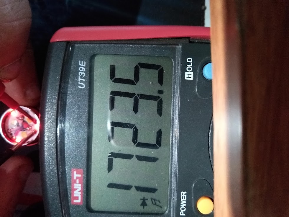

My numbers are mostly swags. I like the light output of the Aux LEDs with 1.7V across them. So I did some more measuring. With the driver board connected and the Aux mode set to high, I see 1.88V across the aux LEDs. Set to low, I see 1.63V across the aux LEDs.
When I measure the current my DVM puts through the LEDs to get a “nice light” its about 0.4mA. If there is a sort of regulated 3V driving this, then (3V-1.7v)/4.3K is 0.3mA. So this all seems reasonable to me, as zumlin reported that he liked a 4.3k ohm resistor in series.

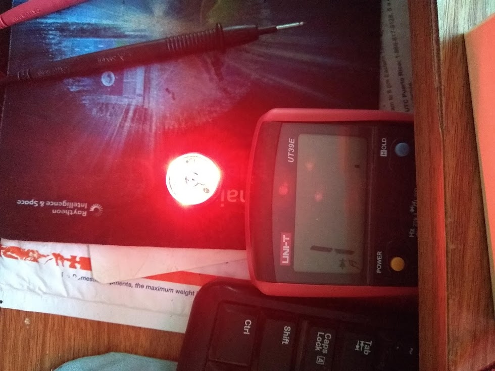

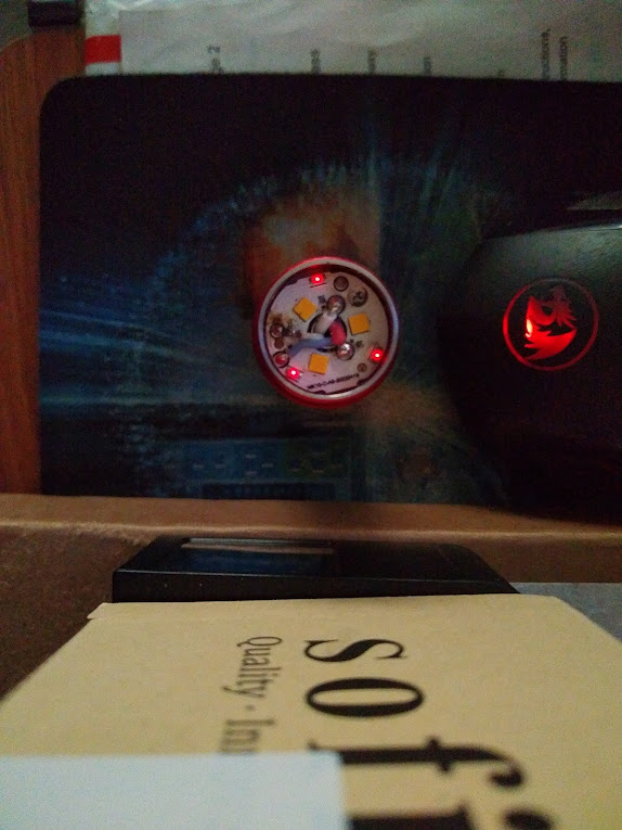

Some pictures of my work today.
This is the “just right”, using my DVM at the source of power for the aux LEDs
This is Aux high with the driver.
This is Aux low with the driver.
