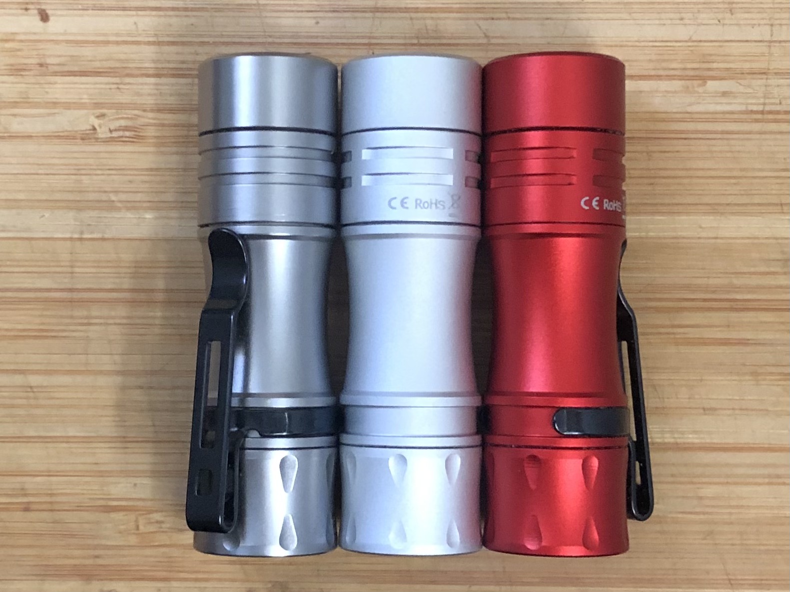

carry weight of TiTS10 w battery and clip: 64 grams
aluminium TS10 w battery and clip: 51 grams
the Ti is 25% heavier
