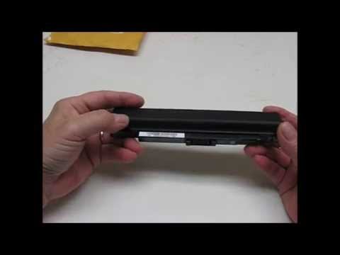

Video tear down of a laptop battery pack
I made a video of how I opened my first ebay battery pack.
www.youtube.com/embed/qFgTR1DDj_o
I have never tried before, so it's a novice's approach.
Here's a search link from ebay for it.
The cells inside are Samsung ICR 18650 26C. There were 6 cells in the pack.
The voltage averaged 2.0 volt, the high was 2.56 and the low was 1.98
I am not 100% sold that the actual cells are Samsung. There are numbers on the cells, beneath the wrap and they are all different numbers, so I do not trust the quality or age of this thing.
The pack was new, but most likely Old Stock.
The video just shows how I got them out and prepped them.
Once they are charged, if they appear to work as new, I will sell them. I don't have any need for them. I just wanted to tear down a pack.

Great teardown OL. No gloves and no cuts, great job for the first teardown. I can’t wait to see the voltage on the after all charged and tested.
I am going to try to work on a laptop batter tear down and yield chart soon.
Well I ordered a couple of packs, I like these samsung cells, thanks for the video. I like to leave the welded tabs on and cut close to the middle and burnish the cut edge with a socket extension or the like, as I’m chicken I’m going to tear a hole in the end of the cell. Hope they take a charge :slight_smile:
