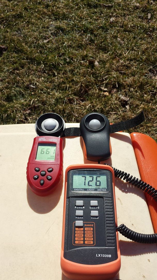

So I got an LX1330B luxmeter, but haven’t checked my Courui or any other lights yet (been working on my I.S.). Did get this check out in the sun though (both meters on x100 setting):
Seems to explain my low readings.

I know my LS1330B meter has been working very reliably. Seems like every time I suspect something is wrong, it’s something else, or my own dang fault. Watch out for readings goin up when the battery starts dying. Other PIA is leaving it on and draining the battery - do this wayyy too often. I recall manxbuggy1 had this meter and a higher end one he spent like $150 for, and said the readings were the same, but the pricier unit of course had a bunch more features he wanted.
Thanks for the feedback Tom. Continuing off-topic duscussion, would you think the HS1010 & HS1010A perform ok for sphere use where even though it’s readings may be wrong, the calculations are based on calibrating to a known light (or a few known lights)?
-Garry
Well, all depends how it’s off: offset or scaling. If it’s an offset problem, then yes, good for a sphere. If it’s a scaling problem, that gets tricky, because the higher the source, the more it’s off. It could be a combo of both calibrations, or could be an inconsistency issue, varying excessively by temperature or battery level for example.
I wouldn’t risk it, but of course money is money…
For my LX1330B, I don’t apply any cal factor - for throw, I use the reading directly. I’m making a big assumption it’s calibrated close enough.
I’m also interested in this OT discussion RE: whether the HS1010 has an offset or poor scaling. I picked up an HS1010A a while ago and never played with it much.
