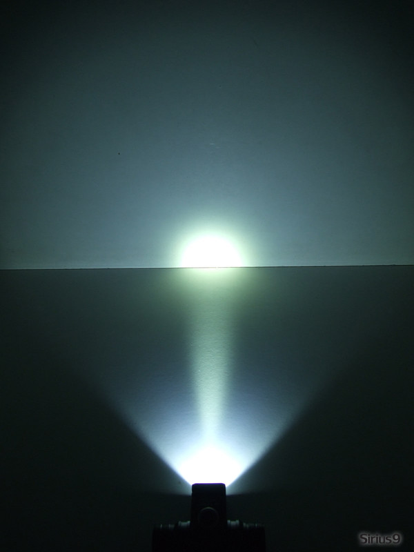

It is a nice and useful light, I use it mostly when tinkering with small electronic parts, soldering, etc because i have poor room lighting, I use mostly low and mid mode, high hardly ever and it does the job well, better than XP-G2 based Crelant CH10
shutter speed |
Mode |
High |
Mid |
Low |
1/1000s |
1/800s |
1/640s |
1/500s |
1/400s |
1/320s |
1/250s |
1/200s |
1/160s |
1/125s |
1/100s |
