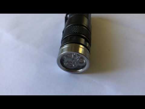

I want to swap out the emitter, its TOO BLUE for my taste.
I am thinking, hmm about going Warm, very warm ICAN warm…7A-8C range.
Anyone for some choices for an emitter for this ?
Not touching the ring or driver as they work fine.

So let’s get back on topic here… As you can see I have removed my bezel and added a glow spacer between the emitter and reflector. I also added some sexy color to the Ti bezel. No issues or damage.
Light uses a XM-L2. Maybe I’ll stick with the xml2 and go with a t4 7a tint from leddna…again driver is not going to be swapped. I wonder if that 600lm # goes down with the warmer tinted emitter…
