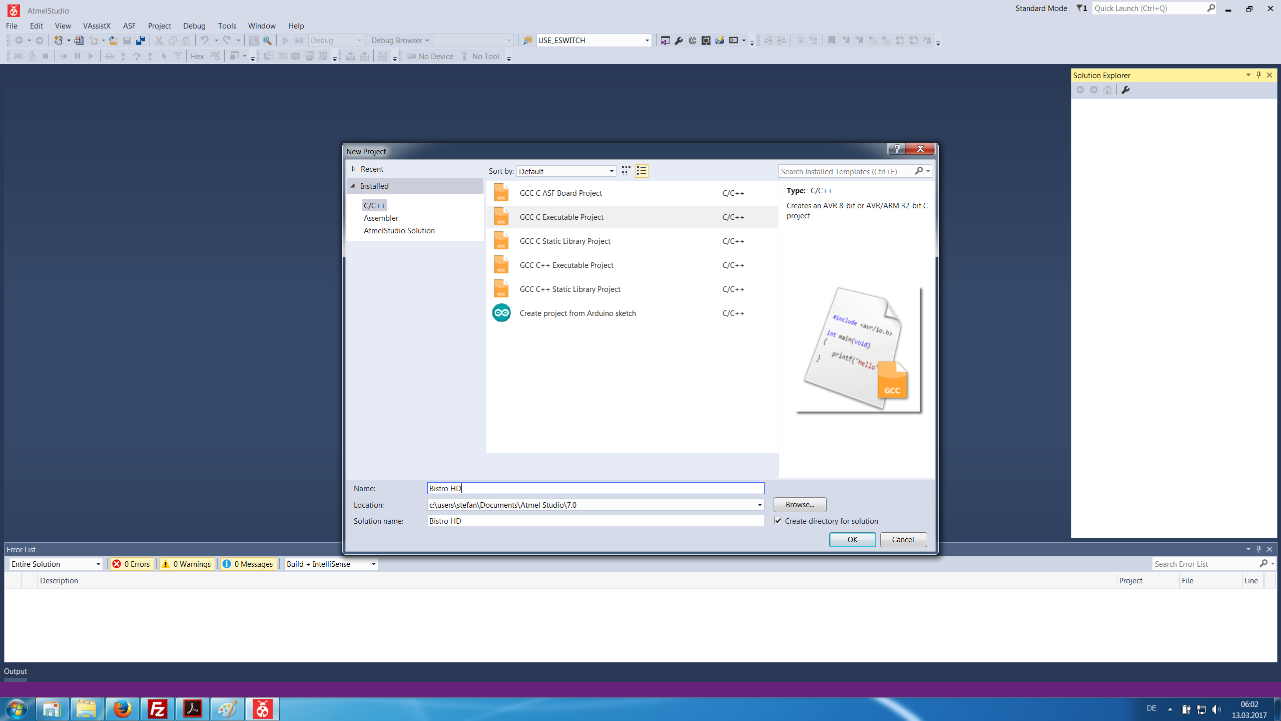

New project

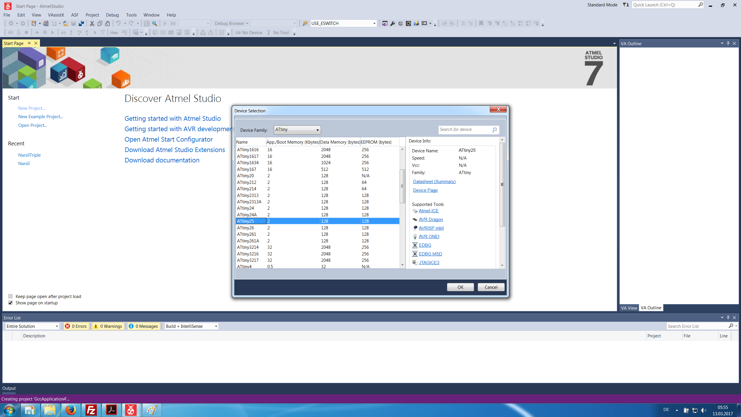

Select your Chip
if you use a different than the 25 you need to change that in the BistroHD.c file as well

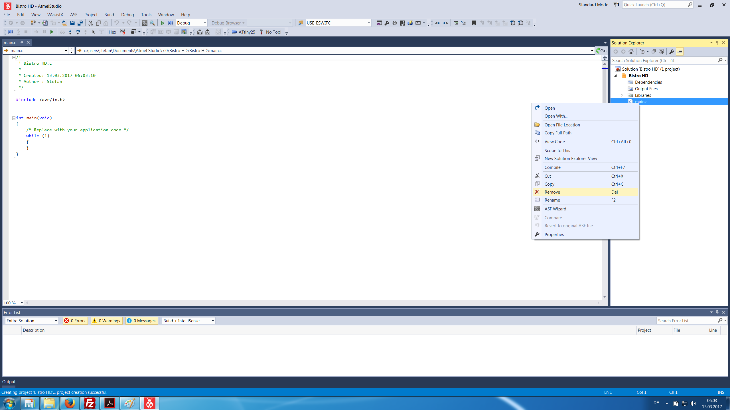

Delete the main.c

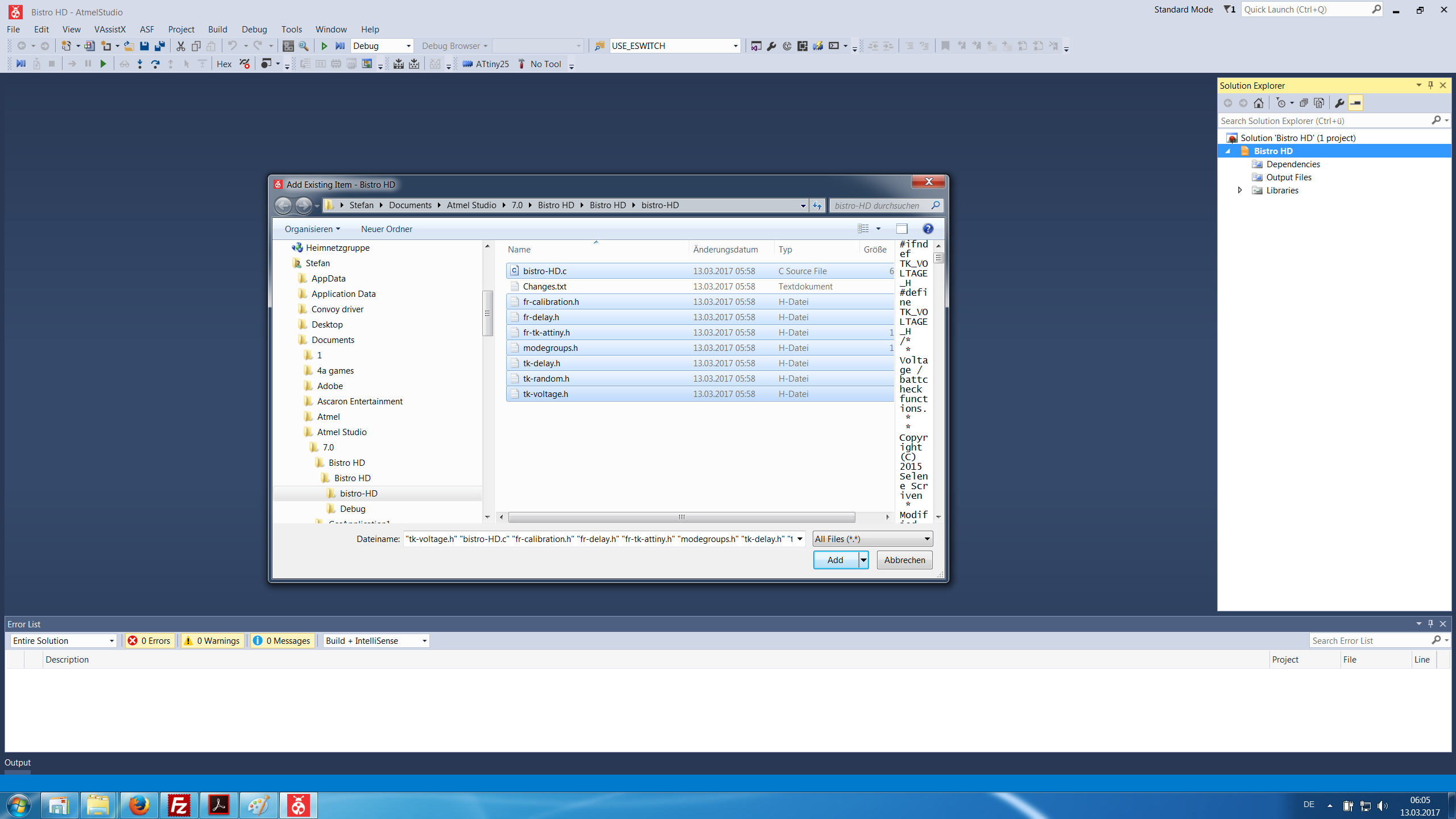

Getting the files loaded
Load all the files for the solution

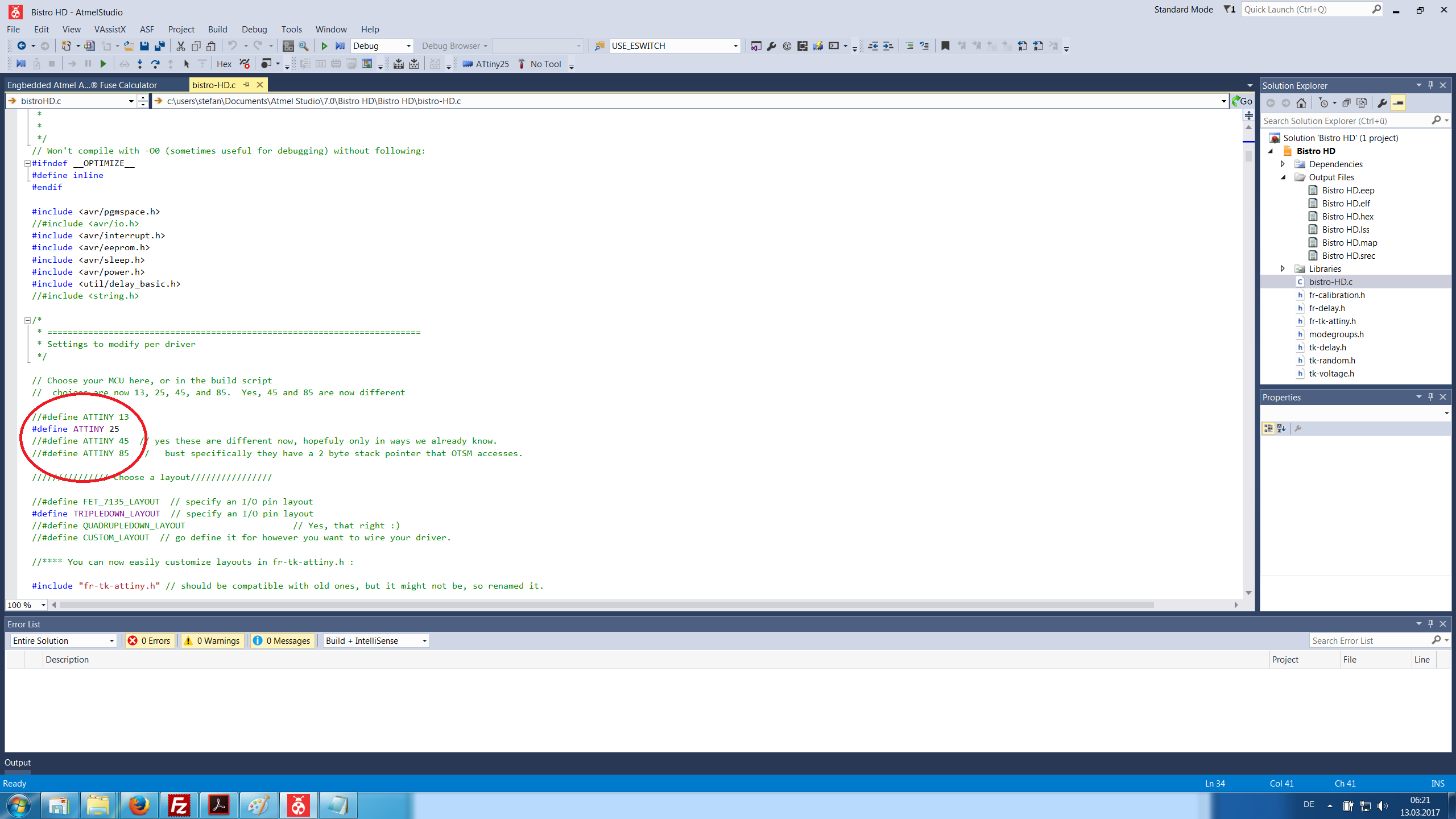

Building the hex file
here you find the hex files
