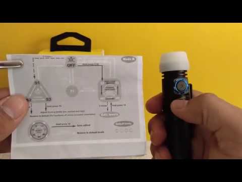

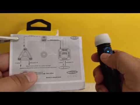

Configuring “Blinking Modes” brightness
This video shows how to configure the brightness of the 3 blinking modes.
This operation can only be done while on the Group Mode B.
FROM OFF :
- Triple Click - Turns the light ON in the “blinking group” (“Strobe”, “Slow blink” or “Fast blink”, depending on the last used mode)
- Triple Click - When on blinking group, the triple click enters the configuration mode. Then:
a) Double Click to alternate between the 3 blinking modes
b) when you’ve chosen the mode you want to increase or dim brightness, Press & Hold the switch for more than 1 second until you notice more or lesse brightness
c) to save that new brightness level, Single Click exit the configuration mode turning the flashlight OFF
d) to restore the default levels, Triple Click when the blinking modes are active.

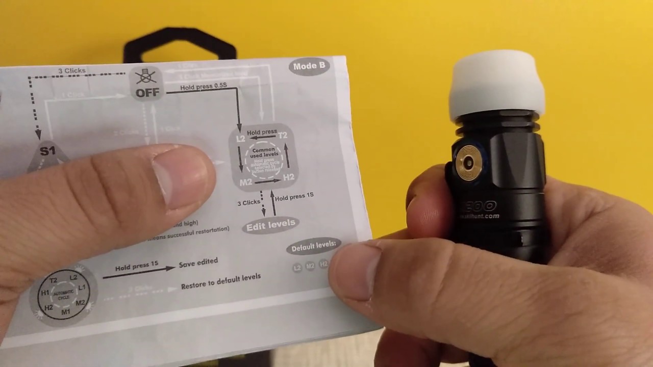

Configuring the amount of modes on Group Mode B
This video shows how to configure the brightness of the regular modes.
FROM OFF :
- Single Click - Turns the light ON in the last used mode
- Press & Hold 0.5s - Turns the light ON in the lowest configured mode
FROM ON:
- Single Click - Turns the light OFF
- Double Click - Enters Turbo 1 (T1, the brightest level)
- Triple Click - Enters the levels’ configuration, the light automatically starts cycling from Low2 to Turbo2 (L2 - L1 - M2 - M1 - H2 - H1 - T2), and the switch will blink RED on each of the already selected levels.
Ex: if the default levels are selected, the light will blink on the L2 - [blank] - M2 - [blank] - H2 - [blank] - T2 - L2….
When on the level’s configuration:
a) click the switch when it is RED to unselect that mode
b) click the switch then the switch doesn’t appear RED [blank] to select that mode
c) Press & Hold the switch to save the selection done (the light blinks and then goes to the lowest configured mod)
d) Triple Click to restore the 4 default modes mentioned above.
