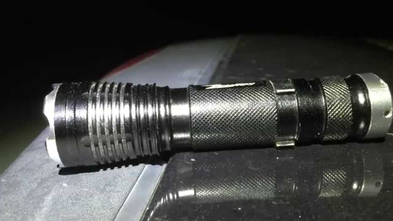

Exterior Design & Ergonomics:
The Zeusray is a compact pocket friendly zooming flashlight that runs on 1x18650. Obviously it is
physically bigger than the infamous SK68 due to being an 18650 torch. It is short and smaller than
a Solarforce L2.
The head uses a plastic aspheric lens, however the quality of the lens seems very good on both of
my samples. The lens is also substantially bigger than that of the SK68.
There is a plain aluminium crenalated bezel. It is not sharp nor can you notice the crenalations
when carrying the torch in your pocket. But it does enable it to head stand and obvoiusly offers
some protection for the lens.
The head is grippy and easy to slide from flood to zoom, even one handed. The main body is also
grippy enough and has a brilliant pocket clip (a clip used on other more pricey flashlight
offerings).
The tailcap is a simple plain aluminium one houseing the switch. Both of my examples tail stand
perfectly with no wobbling at all.
It’s comfy in the hand and in the pocket.
Anodising is typical of this end of the market, but if perfectly acceptable in my book. Neither of
my examples appear to have blemishes or mark easily.
The threads on the tailcap are also square cut. General machining qulaity seems to be very good.
