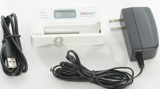

I did not get the charger in a full retail package, but instead in a envelope.
The envelope contained the charger, a universal voltage (100-240V 50/60Hz) mains power supply and a usb cable.

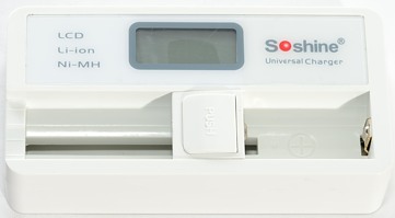

The plus connection is slightly raised, this means that the charger can be used with flat top batteries.
The minus connection is a slider that can be manually moved . This gives a span from 26 mm to 70 mm long batteries.
I would have liked a spring in one of the ends, this would have made the adjustment easier.
The negative end can be used as a spring, but then it must be moved in, before the battery is placed in the charger.

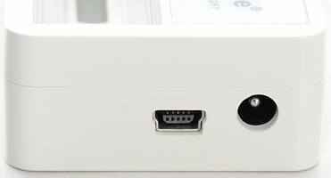

Power can be supplied from a 12 vold adapter or from a usb power supply, in both cases it requires a 1A power supply.

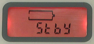

Instead of the typical red/green leds, this charger uses a display to show status information on.
When no battery is in the charger it shows this standby display. There is a faint clicking sound from the charger in this mode.

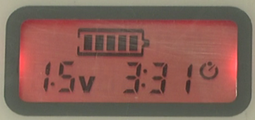

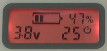

While charging it shows the voltage and the time used, with LiIon it will also show an estimate of how many percent capacity is charged into the battery.
The voltmeter has some limitations, for LiIon it will not show below 3.3 volt or above 4.2 volt, it will stay at these voltages.

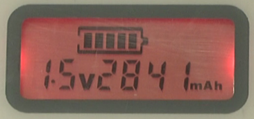

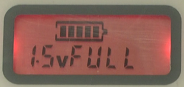

When done the display will show a battery full message, then show the time used and the capacity charged into the battery, these 3 displays will cycle. The capacity is not a precision measurement, but good enough to compare LiIon batteries and see when it is time to replace a battery (Remember the battery must be empty to measure the capacity).

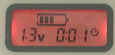

For NiMH the value will be way above the battery capacity, these batteries need some extra current when being charged.
The charger can handle 70 mm long batteries including flat top cells.

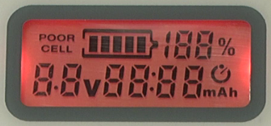

My old IMR cell, did not work as expected, after a short time the "Poor cell" text turned on and it showed "FAIL" on the display. The charger has a point about the cell.
I have also seen the charger only show "Poor cell", but continue to charge.
