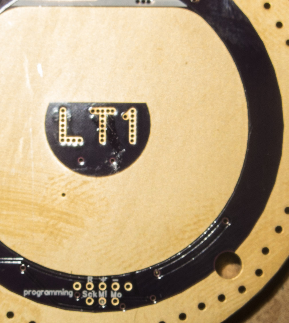

The following picture shows a pre-version almost identical to the now shared projects and works very well. The pcb is 0.8mm thick. Pogo-pins are 0.68mm diameter, 16mm long (P50-B1).
Via drills on the driver are 16mil (0.4064mm). Distances are 1.3mm between left and right vias and 1.5mm between up and down vias (via center to via center respectively).
I bought pogo-pins from Banggood and from Fasttech. Both are extremely similar, although not identical.

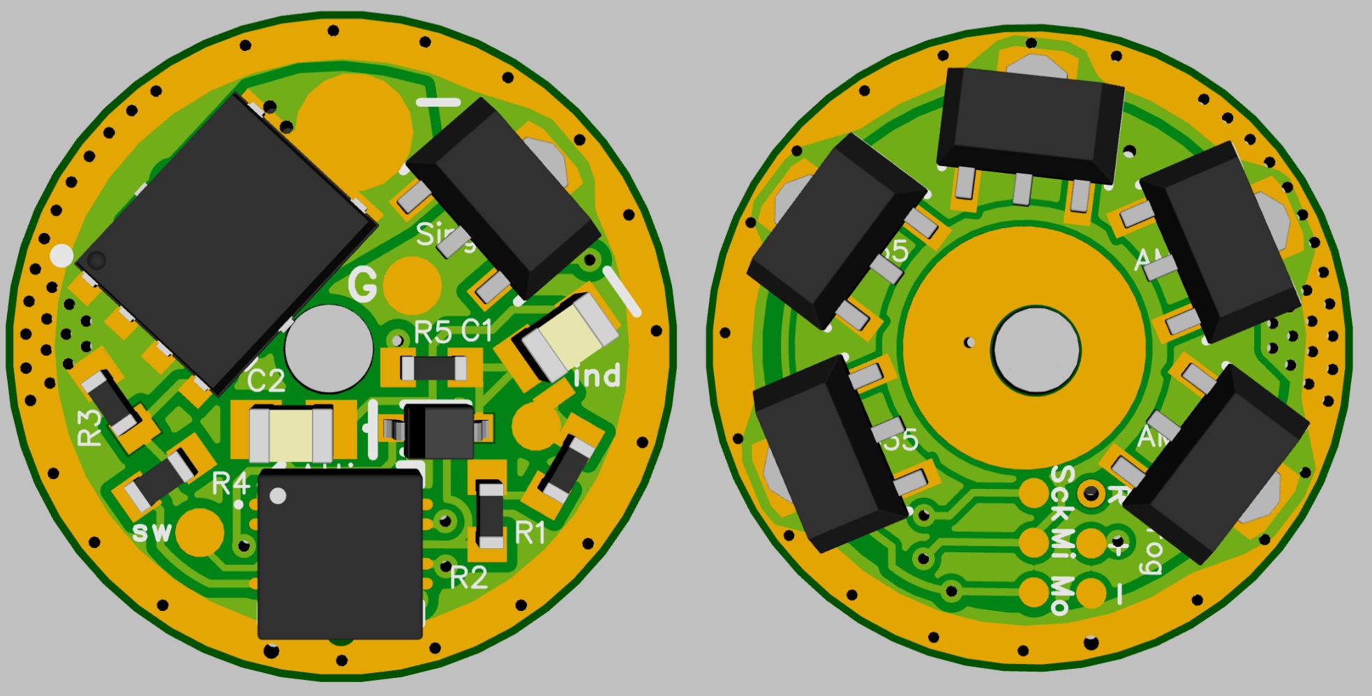

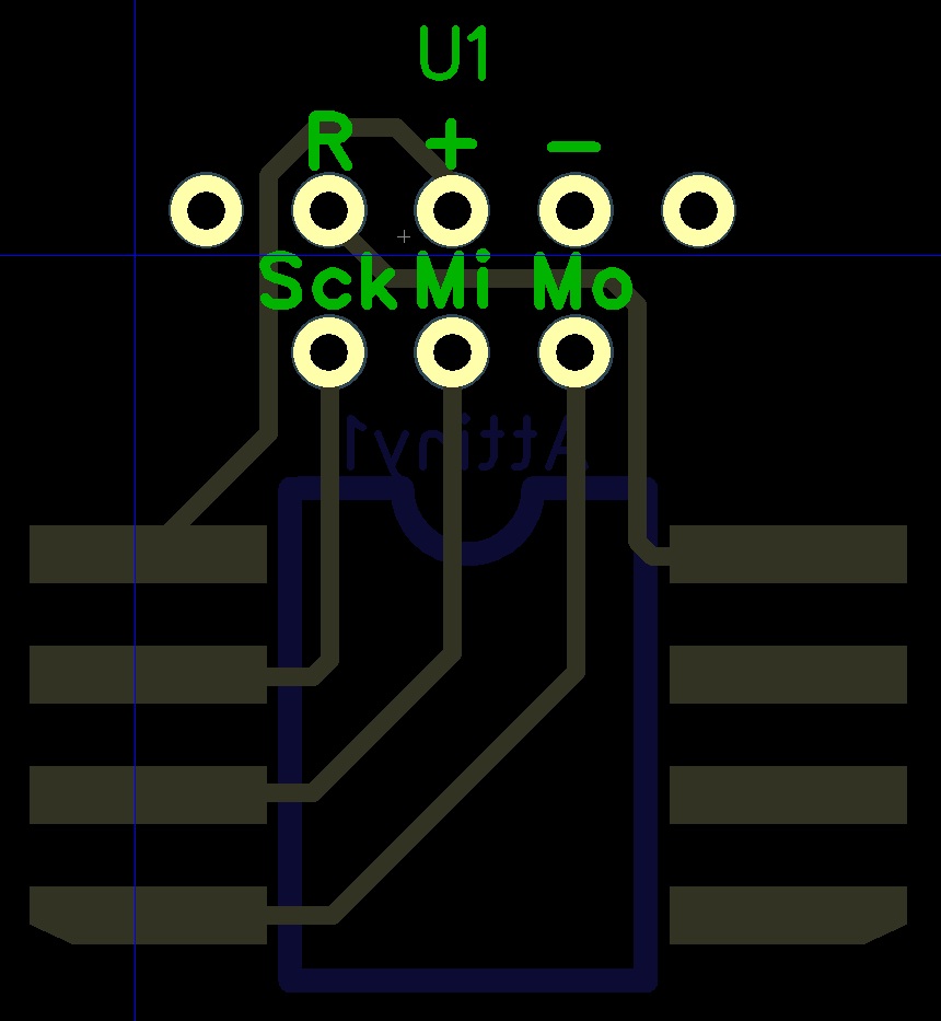

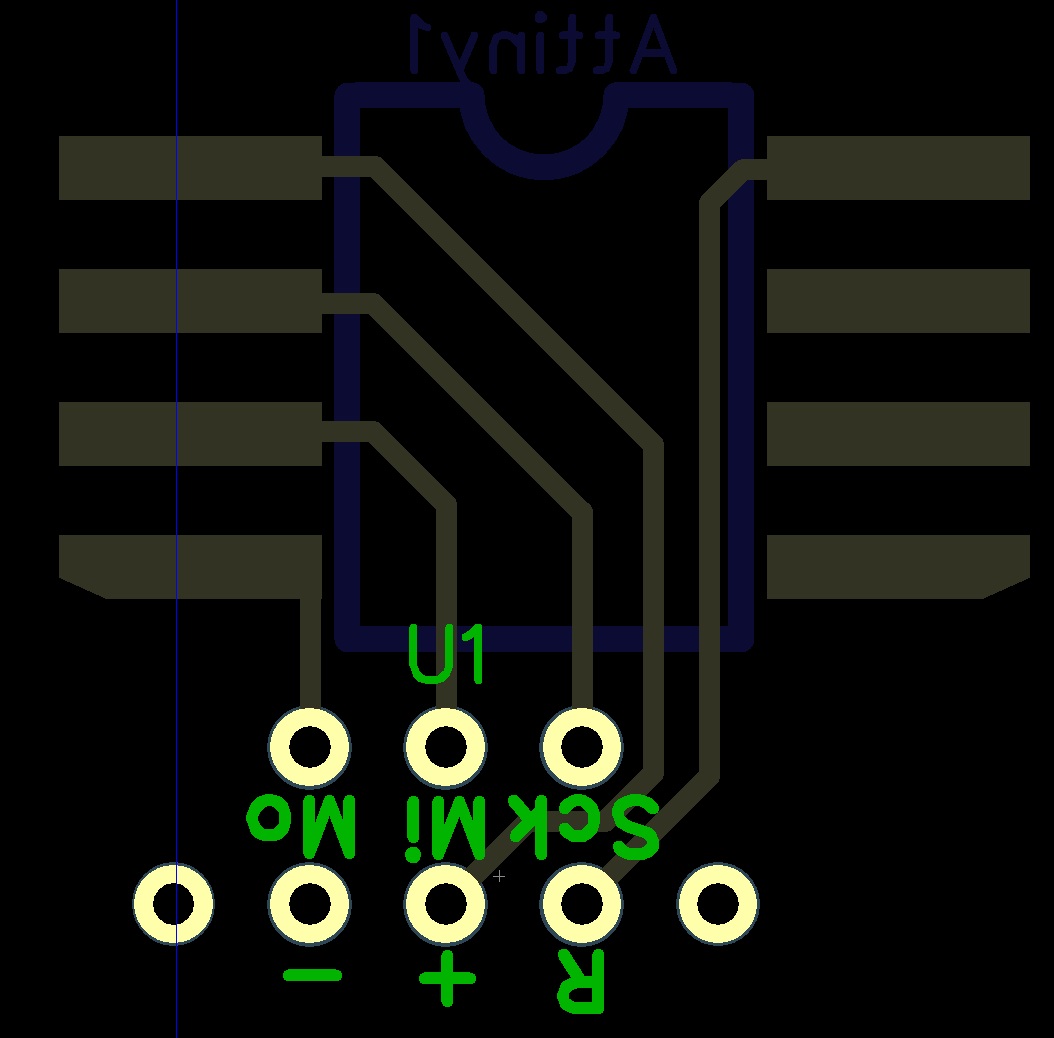

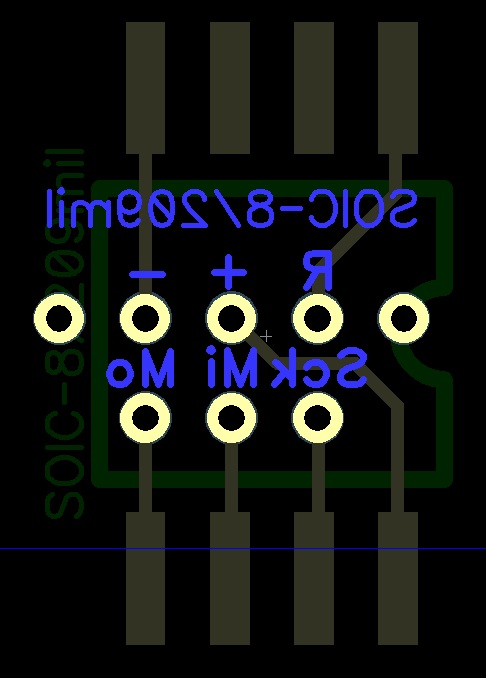

Sizes and Application Examples
To fit this key, the vias need to have a distance of 1.3mm/1.5mm.
The actual Oshpark design rules (oshpark-2layer.dru) allow for a restring of 5mil and need a clearance of 6mil. So routing between the vias can be up to 12mil/20 mil.
I find the 5mil restring too small (knowing that Oshpark has some margin of error for the drills) and prefer the older restring size of 7mil. That still leaves 8mil/16mil for wires.
This is the pin layout from the programming side, which is not the side with the MCU, so it’s mirrored (the Attiny looked at from the bottom).
On small boards there is not enough space for full naming. On the right side of the picture the letters are size 0.6096mm (24mil), ratio 15%, this is about the smallest that Oshpark can handle to stay readable. So my naming scheme will be
O for MOSI
I for MISO
S for SCK
V or + for VCC
R for RESET
G or – for GROUND

I also got my final revision 3.2 also launched now,
too bad I got made 120 boards here where the 10 pin header wont work and solder connection markings do not fit if want flash driver from bottom side
the pins are mirrored because I made an mistake looking in my program on drivers bottom which auto mirrors
Order in 2OZ for 0.8mm board thickness from Oshpark!
https://oshpark.com/shared_projects/o1pUPNqt
I got some that cant use the header as they were produced mirrored
applying solder paste one side
soldering pins to it and applying thermal glue for 2. side reflow
Both sides soldered, fine alignment of the pind with soldering iron carefully after that picture

staticx57 wrote:
USB and Firewire all over again. Can we agree on HQ or Lexel or find someway to make them work together?
as far as people stick to my driver pin layout they can use his universal key,
but need to arrange the jumper wires differently to his driver
,same with his driver and my key they would need for the 10 pin connector an adapter or solder the wires on the key differently
both those scenarios are not really good, best is to stick to one solution
We will have soon a BLF lantern going into production with my driver pinout and i already started to put it on my new designs, so best is to stick to it
5×3 is the full size and 3×2 the minimum size
I also got my final revision 3.2 also launched now on Oshpark
the v3.1 boards i have here can be used but with some advise
I got made 120 boards where the 10 pin header wont work when used with 1:1 wire, 4 traces need to be swapped out
- and R are swapped and Mosi and Sck
Production
final key with soldered wires not connector
